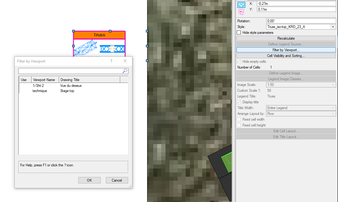

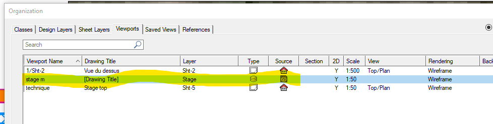

Hello there is a filter by viewport 😉 i

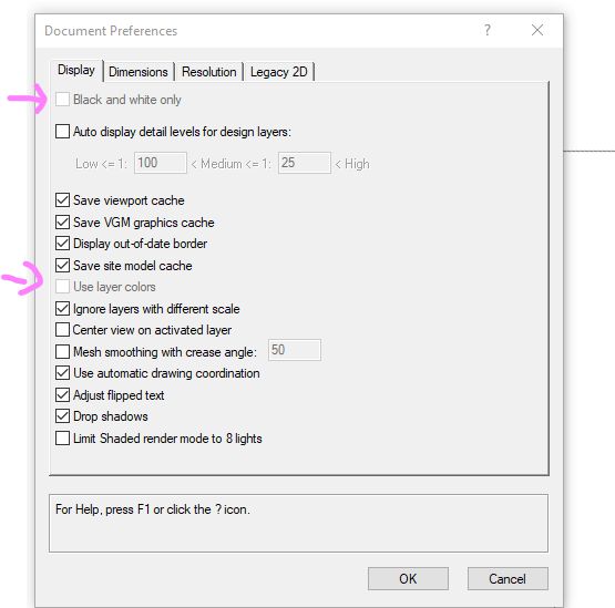

Hello I'm working on a file from a colleague I click on the Use layer colors button , but nothing appends. So I open an empty file , copy and paste stuff from the other file, and the Use layer colors works... So go back in the colleague file , document preferences And the use layer colors (and black and white option too) option are grey . I suppose that an option is checked somewhere, but I can't find it ... any idea ? thanks

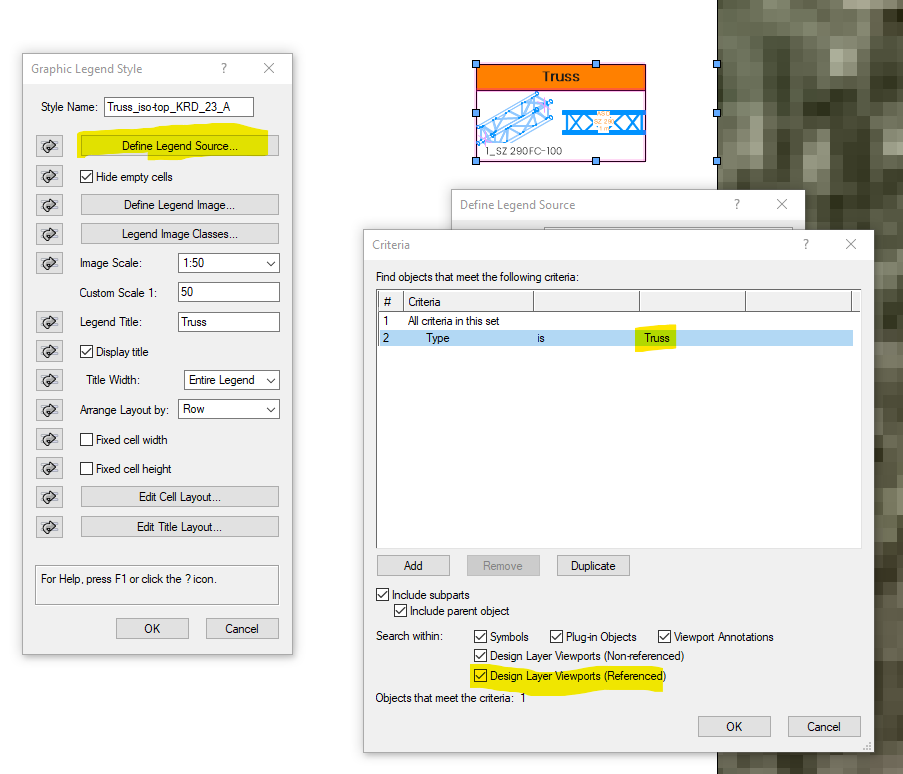

Sorry, it works with type is truss type, but it don't works with truss record is present ...

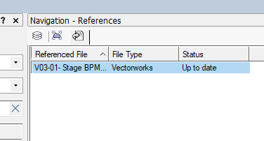

Is a way to use graphic legend in a vwx with a vwx file as external file ( on a sheet layer of course) It seems to work only with stuff from the file and not the external one, and I can't filter by viewport, because the external file doesn't appear in the list ...
