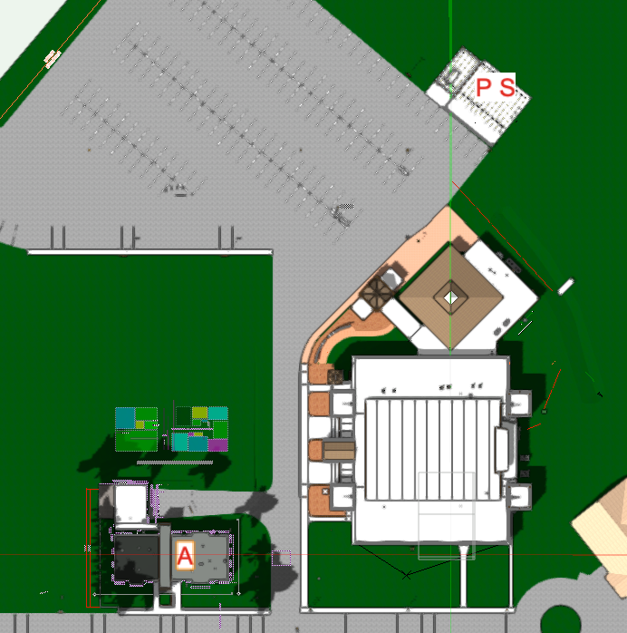

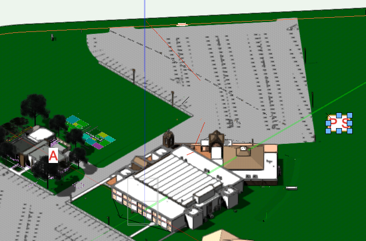

Thanks for the replies. Indeed, I also thought about the "fit to all objects" command, but it doesn't solve the problem. I'm suspicious that the missing picnic shelter shows only the 2D top/plan part, and doesn't show any shadows or 3D parts when rendered in Shaded nor RW. It is not a hybrid symbol. IT does not show 3D parts in wireframe (it is missing in any 3D view). I changed the view to 3D isometric in the source file, with no result. Is there some way to tell VW that the source file has 3D objects ? IT seems that my main master file just thinks of this as a 2D plan image. The main file has stories, but the source file for the shelter does not. Could there be something going on there ?
I need help for this simple problem: I have a large file of a church complex that was started 20 years ago. The file currently has at least two exterior references (Viewports) to other files. One reference is for a separate building (in a separate file), and it works perfectly. I just tried to add another reference for a picnic shelter (which is in a separate file) and it does not display correctly. I attached two images to explain this. The "imported link" image shows the complex and the link that works perfectly for the other building is shown with a big red "A" on top, in the lower left corner. That image also shows my 'new' picnic shelter near the upper right with a big red "PS". The second shows what happens when I type '3' on the number keypad to change to an isometric view. The entire Picnic Shelter disappears. The other building 'A' is still in place, with perfect display. I've scratched my head so much while checking all visibilities and preferences and anything I could think of, that I am now bald. Please save my scalp by telling me why this is happening. I'm not completely confident that I imported the referenced file correctly, but I must have done something right, since the Picnic Shelter shows up in the "top/plan" and "top" views. It simply does not show up when changing to isometric views. Thanks for any tips .... (using VW Architect 2024 on Mac OS Sequoia)
