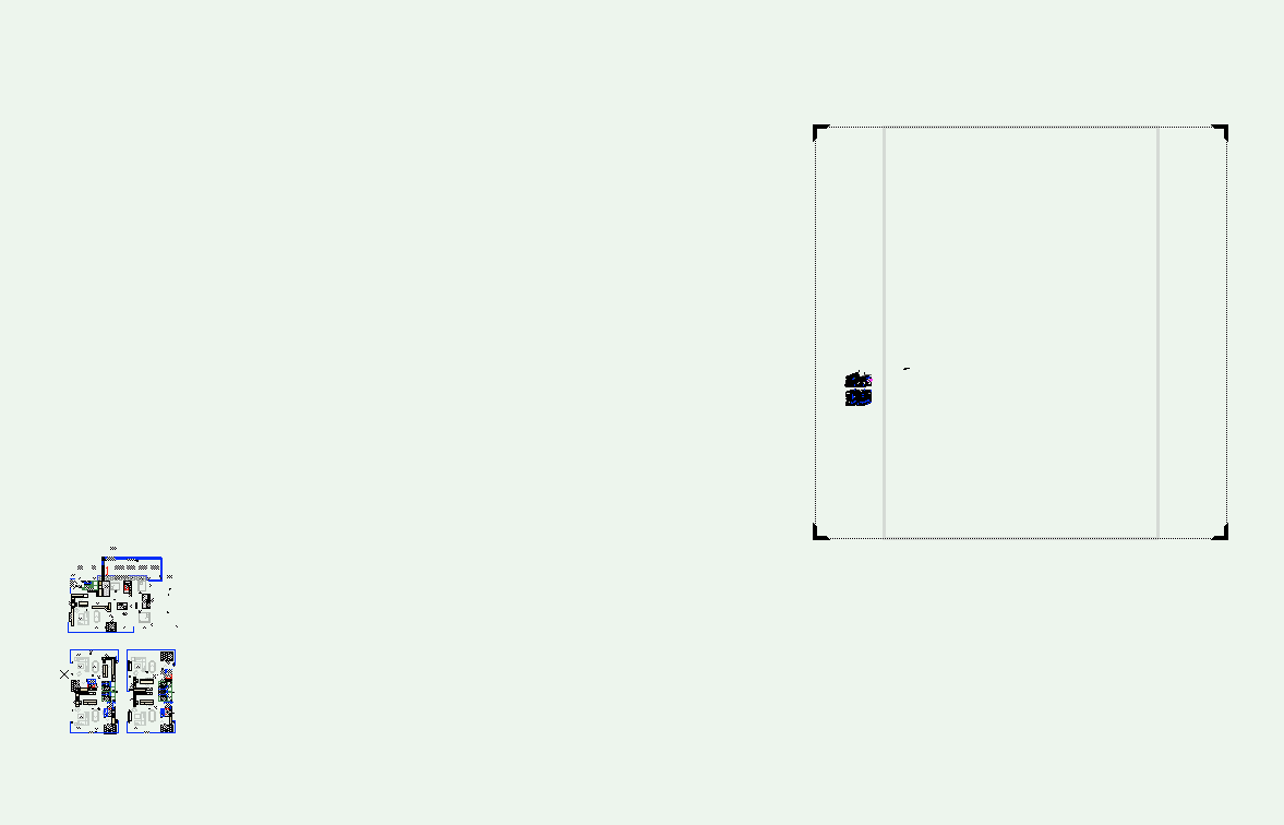

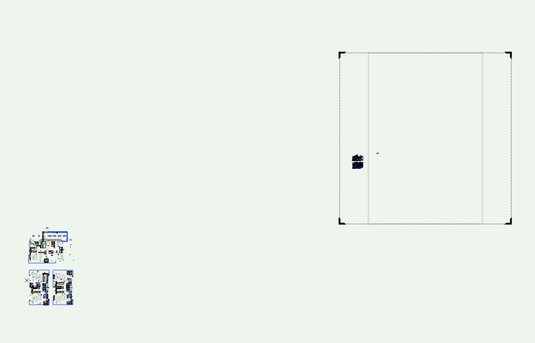

  5. hi all, Can someone please point me to some reference material online or elsewhere on how to go from 2d top down plan view to a decent 3d perspective view so that I can see what I'm constructing. I've been working in the 2d realm for waay too long (ie. manually drawing sections & elevations) and I just wanted to finally break that pattern but it just seems so convoluted in VW to simply change to a perspective view. Aside from setting up the levels and storeys (which I do in 2d plan view already), how can I switch to a 3d perspective view similar to that of Sketchup (yes, I'm sure I'm not the only one who has referenced good ol' Sketchup as a ground zero). So far, all I've done to get this frustrated is: I'm in the 2d plan view and then I go to View > Projection > select Normal Perspective that's as far as I can go it seems without knowing more on how to configure what comes next: see attached screenshot: I've got the elements in my 2d floor plans (bottom left side) AND what appears to be some viewport for the perspective view (???) on the upper right - so far so unintuitive! I have no issues going to the Isometric views - it's the perspectives that are driving me up the wall. I'm sure this is normal and I'm just missing some setting(s) or... something to correct/adjust this view but if anyone can point me in the right baby steps direction, that would be huge. Thanks all! J Vectorworks 2024 SP8
