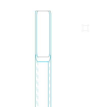

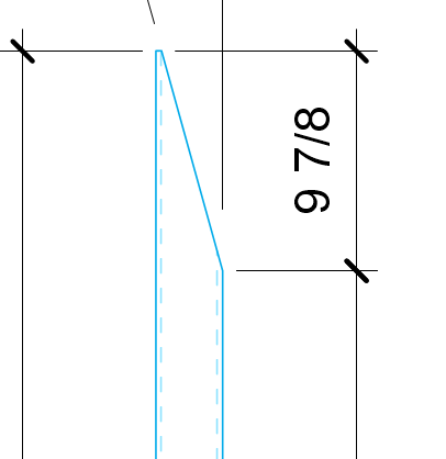

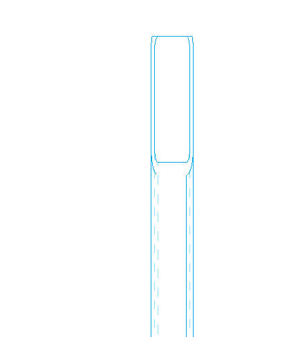

Hmm, that is an interesting aspect of rendering priorities I had not been aware of beforehand. I was anticipating that I could get both hatch patterns to be visible at this location. I had placed the concrete hatch first anticipating it would be in the background vis a vis 2d hierarchy protocol and removed the background of the second hatch. I adjusted the placement as you suggested moving it 0.5 forward of the concrete hatch and for good luck removed the background of the concrete hatch, but ultimately was unable to get #1 viewport to render it as Hidden Line rendering. Increased smoothing to 20°. Only in wireframe was I able to see both patterns and while shaded rendering completed it too masked the concrete pattern with the other hatch instead of showing through. Shaded rendering does not seem to recognize alpha channels of hatches. -

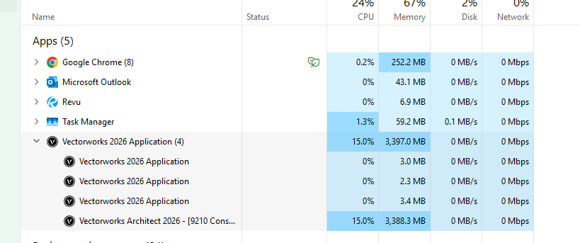

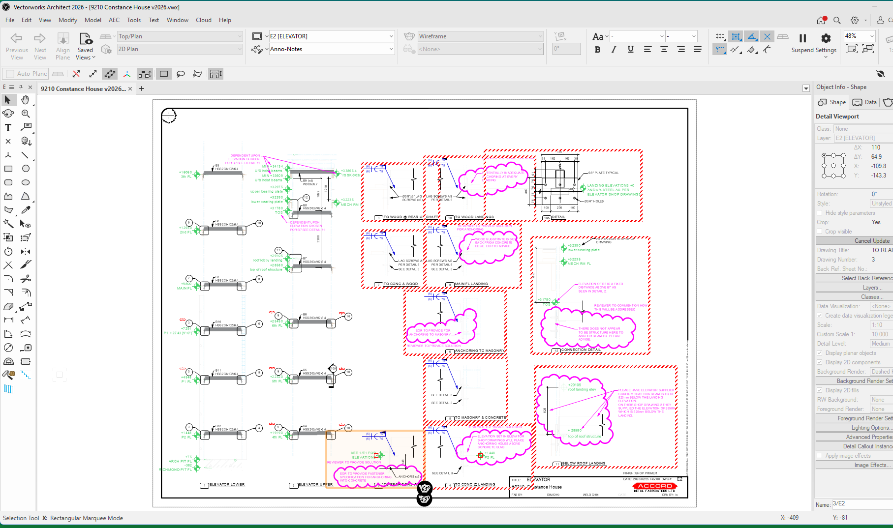

Take #7 for instance. set background render to dashed hidden line and check display 2D fills, then attempt to update the view port. While that is processing do the same for #3 and wait a minute before pressing update to see if #7 finishes quickly. #7 might partially regen but not come into focus. Which is the point at which I pressed update for #3. This is the memory use after more than 15 minutes while processing only 2 viewports. -

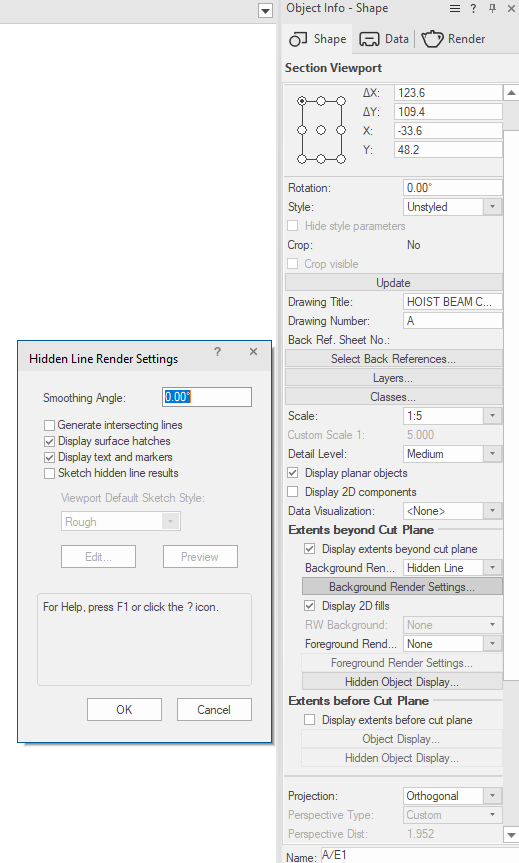

I missed mentioning that upon import into VW2026 from VW2024 I had to reset all the background rendering for details 3 through 12 to dashed hidden line and tick the display 2d fills box. And change #2 to shaded. While #2 renders quick enough, trying to update just one of the dashed hidden line renders with 2d fills on is not getting to completion after more than 15 minutes. It is looking like I have to use wire frame and hope the reviewers do not get too confused by all the lines that shouldn't be there. -

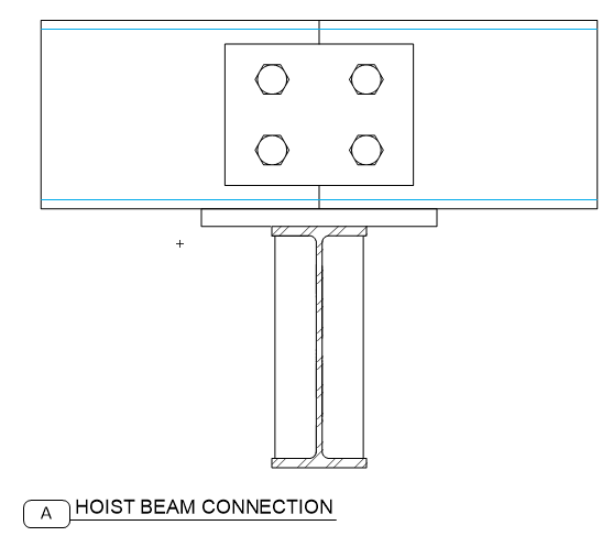

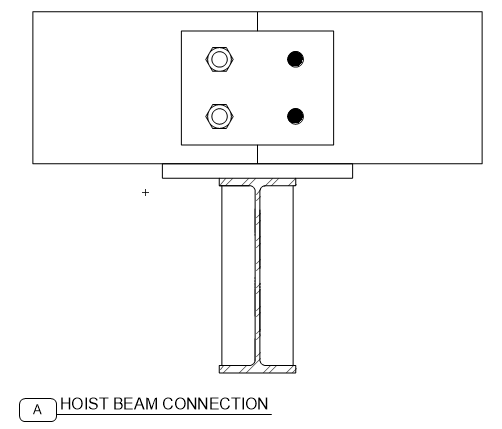

It will likely be related to a fastener such as a bolt or screw. They can be set to automatically adjust to a standard length or manually set lengths. Imperial bolts for instance will want to be 25.4 mm

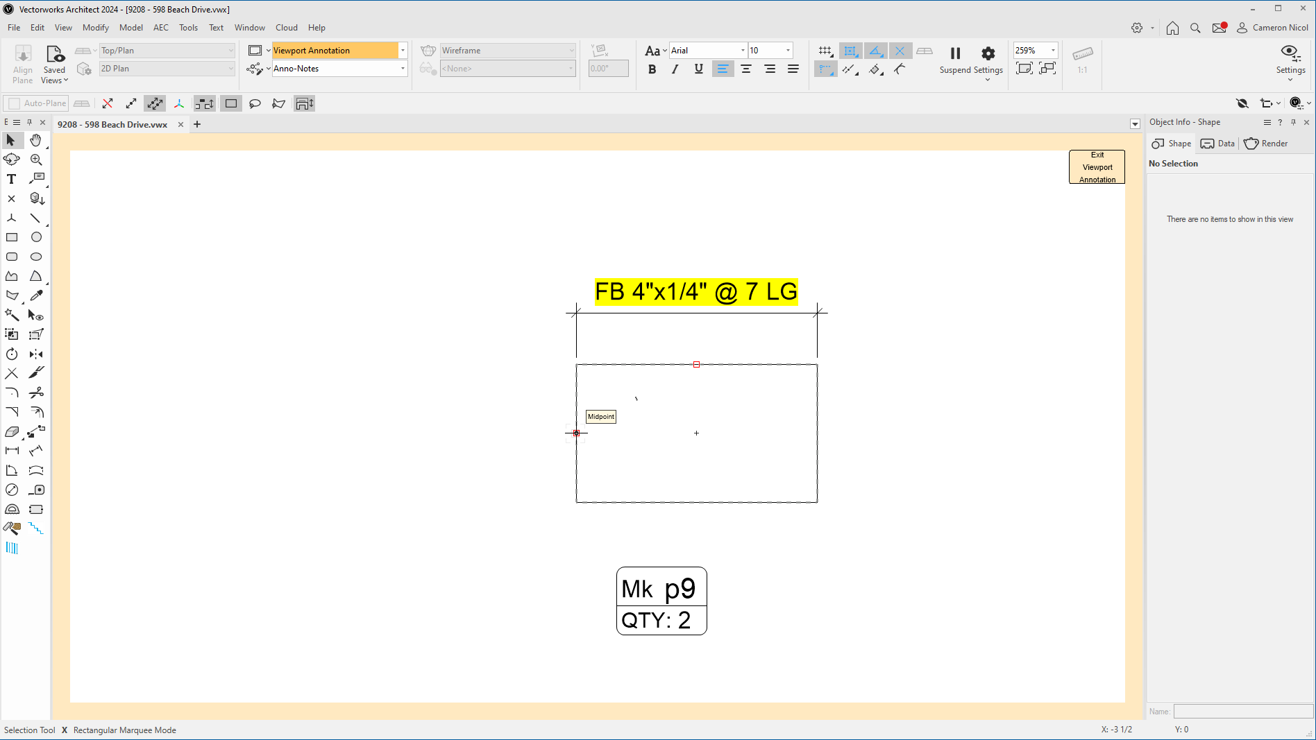

You are going to have to focus on the tool's preferences which are likely stored in an attached data resource. Perhaps it is possible to pre-set a couple of styles (if they don't already exist in the drawing file), then swap the names in and out of a "style field" in that resource. Assuming a style field exists. Data Tag Style changes might just be an embedded procedure that changes all the data fields and is only accessible when the Data Tag Preferences window is active.
