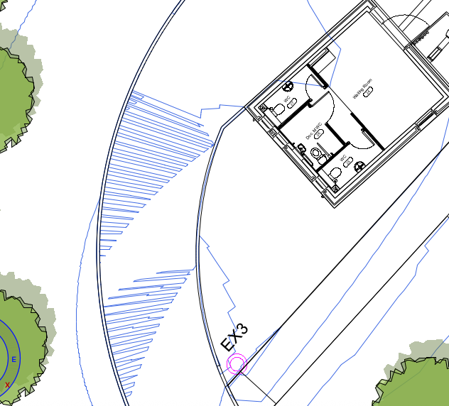

Laura Stone replied to Hugh Chapman's question in Troubleshooting
By the way this is what happens to the site model if you have a radius grade and use it to place a curb object that has modifiers - I think probably a clash of slightly different points along the curve. Workaround is to move the grade to a different layer not referenced to the site model or perhaps could get rid of the front modifier. -

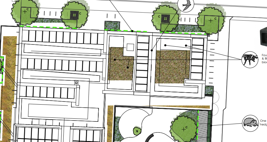

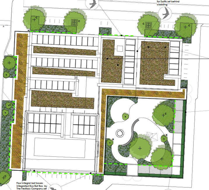

I've had a number of people saying that pdfs I send aren't displaying properly. They display fine for me in Adobe Acrobat or Preview (I am on Mac OS 15.4.1). Any tips on exporting from VW to avoid this issue? Screen grabs that i have been sent and my own below Thanks Laura

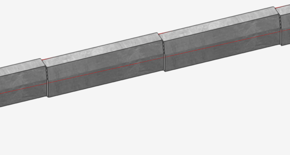

I have an issue with curbs/kerbs in plan where the 'simple' view is showing random areas of individual units, sometimes of the wrong type. I've had a look through the settings and can't work out where I'm going wrong, I know I could work with just extrudes but would prefer to see the units in 3D. File attached with two examples. Laura kerbs.vwx

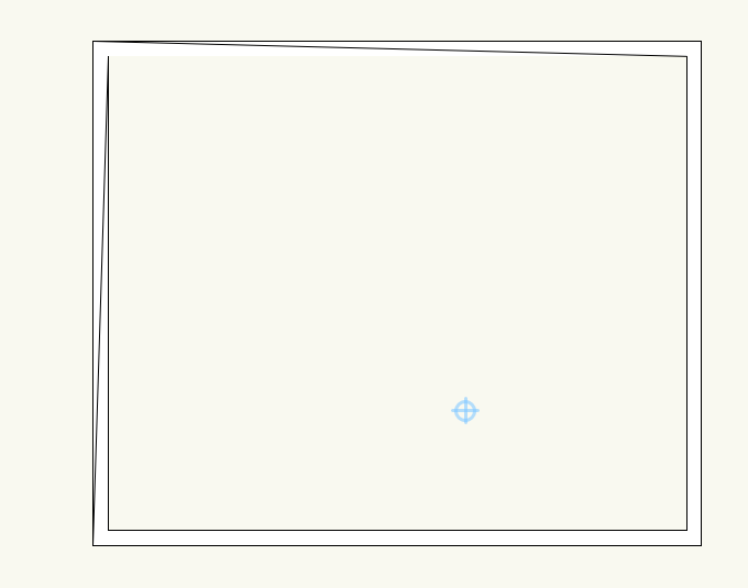

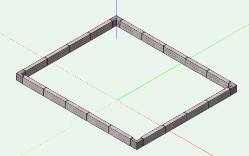

When I have a closed run of kerb I get graphic issues in the area where it closes, see below with very simple kerb. Looks fine in 3D
This is still an issue/bug, any chance of a fix?

Is there a way to switch off the kerb races so that they aren't seen in plan? I've tried putting the extrude into a class that is switched off to no avail. When I ask it to draw the 'simple' kerb in 2D I get the full width of kerb and race. Ideally I'd like the races to be there in 3D but at the moment I'm having to use the workaround of deleting them altogether. Thanks
