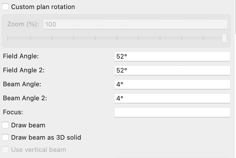

I know that we can do it by entering the Field angle and Beam angle. But in the release notes of Vectorworks 2026 they mentioned that we have now a slider for zoom control of a fixture in the oip. But that one is on all my fixtures grayed out. In the help manual they are mention that when the beam of the fixture is an oval the zoom slider will not work. But for my fixtures all the beam are a circle. Kind Regards, Erik-Jan Berendsen See picture
Working in Vectorworks 2026. Now we have a slider called zoom, for zoom a beam of fixture in de OIP. I have added a few Ayrton Rivale fixtures and for some reason the zoom slider is grayed out. I only can set the beam size by entering the beam angle and the Field angle as normal. What do I need to do to get the slider working for these fixtures. Kind Regards, Erik-Jan Berendsen
