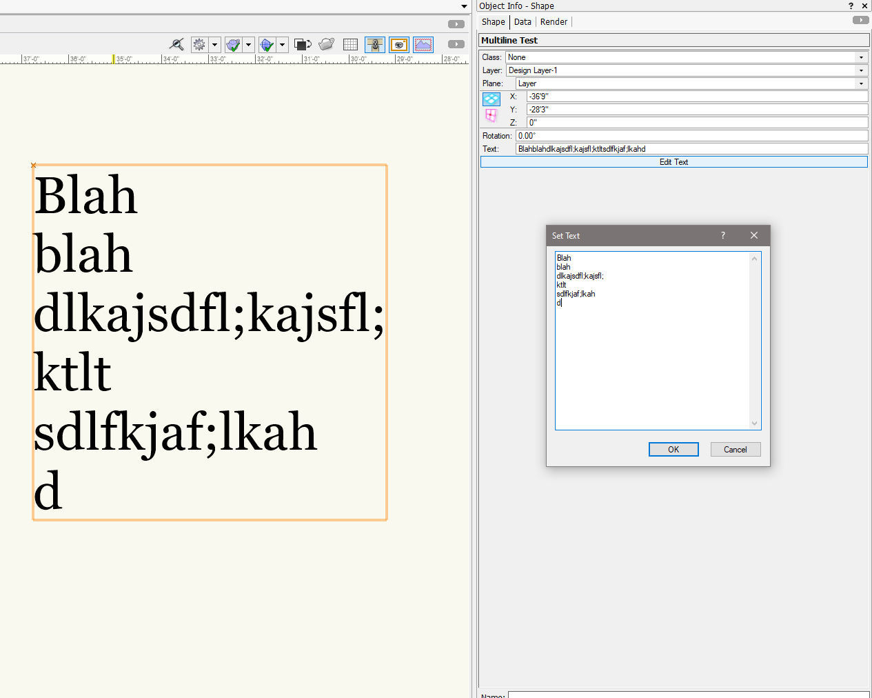

Jesse Cogswell Posted March 29, 2024 Share Posted March 29, 2024 @Marc Powell What do you know about Event Enabled plug-ins? I was able to fab up this quick example of what you might be looking for. When you press the button, it opens a dialog box with a multi-line text box. When you press OK, it passes the contents of that box back to the PIO's parameter using a combination of GetMultilineText and ResetObject. I'm attaching the plug-in itself and have the code pasted below (don't judge, I wrote it in maybe 10 minutes so nothing is annotated). It is a Point PIO with a single parameter, called "text" and is set to Event-Enabled. PROCEDURE MultilineTest; CONST kResetEventID = 3; kObjXPropHasUIOverride = 8; kWidgetButton = 12; kObjOnInitXProperties = 5; kObjOnObjectUIButtonHit = 35; kButton1ID = 3000; kFontEnabled = 800; VAR objName:STRING; objHd,recHd,wallHd:HANDLE; text:STRING; theEvent,theButton,dialog,layoutDialog:LONGINT; result:BOOLEAN; FUNCTION DrawDialog(DName:STRING) : LONGINT; CONST kTextWidth = 50; kTextHeight = 20; VAR dia:LONGINT; BEGIN dia:=CreateLayout(DName,FALSE,'OK','Cancel'); CreateEditTextBox(dia,11,'',kTextWidth,kTextHeight); SetFirstLayoutItem(dia,11); DrawDialog:=dia; END; PROCEDURE DialogHandler(VAR item,data:LONGINT); BEGIN CASE item OF SetupDialogC: BEGIN IF(text <> '') THEN SetItemText(dialog,11,text); END; 1: BEGIN GetMultilineText(dialog,11,text); SetRField(objHd,GetName(recHd),'text',text); ResetObject(objHd); END; 2: BEGIN END; END; END; BEGIN text:=Ptext; IF GetCustomObjectInfo(objName,objHd,recHd,wallHd) THEN SetObjectVariableBoolean(objHd,kFontEnabled,TRUE); vsoGetEventInfo(theEvent,theButton); CASE theEvent OF kObjOnInitXProperties: BEGIN result:=SetObjPropVS(kObjXPropHasUIOverride,TRUE); result:=SetObjPropVS(kWidgetButton,TRUE); result:=vsoInsertAllParams; result:=vsoAppendWidget(kWidgetButton,kButton1ID,'Edit Text',0); END; kObjOnObjectUIButtonHit: BEGIN CASE theButton OF kButton1ID: BEGIN dialog:=DrawDialog('Set Text'); layoutDialog:=RunLayoutDialog(dialog,DialogHandler); END; END; END; kResetEventID: BEGIN Locus(0,0); IF(text <> '') THEN CreateText(text); END; END; END; Run(MultilineTest); The plug-in object attached to this message can be found in the Research and Development category of the Workspace Editor and will work on any version of Vectorworks 2019 or newer. Multiline Test.vso Quote Link to comment
Marc Powell Posted March 29, 2024 Author Share Posted March 29, 2024 @Jesse CogswellI'm pretty new to anything more than basic vectorscript and haven't done any real coding in a couple of decades (even then, it was very rudimentary). That said - THIS HELPED IMMENSELY. I was able to take the small bit of code I wrote for the PIO and integrate your code into it and am now getting exactly what I wanted to accomplish. Thanks a ton. I'm still working on applying attributes to the line work in the PIO and I'm looking to have it draw two different ways depending on which selection is in a particular parameter. I'll share the object when I get it to a somewhat final stage, but this was a huge help. THANK YOU! By the way - how do you like your ZenBook Duo? I bought the same model several months ago and have been loving it. I have an odd issue where my pallets don't want to move down to the smaller screen when I have VW open on the main display. I'll drag them down and as soon as they hit the bottom bound of the primary display, they just won't move any further. The cursor gets down there, but the window just won't move past the bottom of the primary. It's odd. Quote Link to comment

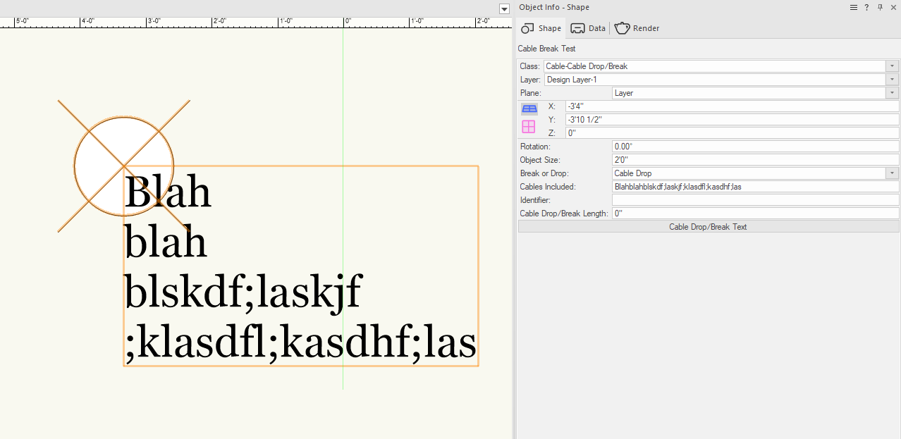

Marc Powell Posted April 1, 2024 Author Share Posted April 1, 2024 Yep... my pallets do the same thing. I'll bet you are correct - it has to do with two separate destinations that have different scaling. I do an OK amount of programing now a days, and it works great for setting up a show before I get onsite. I've pre patched and set groups and such in several airports on my way out to gigs and that touchscreen works very well as a software control surface. Also, its great for when I'm using Vision at home for small test modules. Super quick setup rather than having to get a console in the office. As for this PIO I'm putting together - it works well in it's current state, but I moved around the parameters in the parameters hierarchy to display in a certain in the OIP, and it seems like the text that is entered in the dialogue box only updates the text in the first text parameter in the list from a hierarchical standpoint. I've attached the .vso to this post and here are the parameters as they currently stand: Also, here is the code: Quote PROCEDURE CableDropBreak; CONST kResetEventID = 3; kObjXPropHasUIOverride = 8; kWidgetButton = 12; kObjOnInitXProperties = 5; kObjOnObjectUIButtonHit = 35; kButton1ID = 3000; kFontEnabled = 800; VAR LineVal,NLineVal,HalfLineVal,NHalfLineVal,OvalVal,NOvalVal,HalfOvalVal,NHalfOvalVal : REAL; BreakDrop:STRING; objName:STRING; objHd,recHd,wallHd:HANDLE; text:STRING; theEvent,theButton,dialog,layoutDialog:LONGINT; result:BOOLEAN; FUNCTION DrawDialog(DName:STRING) : LONGINT; CONST kTextWidth = 50; kTextHeight = 20; VAR dia:LONGINT; BEGIN dia:=CreateLayout(DName,FALSE,'OK','Cancel'); CreateEditTextBox(dia,11,'',kTextWidth,kTextHeight); SetFirstLayoutItem(dia,11); DrawDialog:=dia; END; PROCEDURE DialogHandler(VAR item,data:LONGINT); BEGIN CASE item OF SetupDialogC: BEGIN IF(text <> '') THEN SetItemText(dialog,11,text); END; 1: BEGIN GetMultilineText(dialog,11,text); SetRField(objHd,GetName(recHd),'CableTextDT',text); ResetObject(objHd); END; 2: BEGIN END; END; END; BEGIN text:=PCableTextDT; IF GetCustomObjectInfo(objName,objHd,recHd,wallHd) THEN SetObjectVariableBoolean(objHd,kFontEnabled,TRUE); vsoGetEventInfo(theEvent,theButton); CASE theEvent OF kObjOnInitXProperties: BEGIN result:=SetObjPropVS(kObjXPropHasUIOverride,TRUE); result:=SetObjPropVS(kWidgetButton,TRUE); result:=vsoInsertAllParams; result:=vsoAppendWidget(kWidgetButton,kButton1ID,'Cable Drop/Break Text',0); END; kObjOnObjectUIButtonHit: BEGIN CASE theButton OF kButton1ID: BEGIN dialog:=DrawDialog('Contents'); layoutDialog:=RunLayoutDialog(dialog,DialogHandler); END; END; END; kResetEventID: BEGIN {Remove Brackets to create text box as part of PIO} {Locus(0,0); IF(text <> '') THEN CreateText(text);} {Define Variable Values} LineVal := POverallObjSize; NLineVal := 0 - POverallObjSize; HalfLineVal := LineVal / 2; NHalfLineVal := (0 - LineVal) / 2; OvalVal := (POverallObjSize/4)*3; NOvalVal := ((0 - POverallObjSize)/4)*3; HalfOvalVal := OvalVal / 2; NHalfOvalVal := (0 - OvalVal) / 2; {Draw Object} Oval(NHalfOvalVal, NHalfOvalVal, HalfOvalVal, HalfOvalVal); Move(HalfLineVal, HalfLineVal); Line(NLineVal, NLineVal); Move(0, LineVal); Line(LineVal, NLineVal); Move(NHalfLineVal, HalfLineVal); END; END; END; Run(CableDropBreak); I thought I made an edit in your code that would pull the text from and update directly to 'CableTextDT', but that isn't the case currently. Any ideas? I'm sure I integrated the code incorrectly, but I can't figure out where I went wrong. Thanks Cable Break Test.vso Quote Link to comment

Jesse Cogswell Posted April 2, 2024 Share Posted April 2, 2024 The code is working properly as far as I can tell. When you press OK on the dialog box, the CableTextDT is updating properly, as seen in the OIP. Your kResetEventID code currently isn't doing anything with the data (stored in the text variable). If you want the text displayed, you will need to add a line to the tune of: IF (text <> '') THEN CreateText(text); Handles were undoubtedly the hardest concept for me to wrap my head around. All of my coding experience before Vectorscript was with object-oriented languages (Java and Python). With an OO language, you would define an object and all needed subroutines (such as get/set commands) as methods. Once an object is defined, you could assign it to a variable. As an example, you could have something like rect1 = Rectangle(<width>,<height>). The variable rect1 is now defined as a Rectangle object. So if you wanted to get the width again for some computation, you would use width = rect1.GetWidth(). Because Vectorscript / Pascal is not object-oriented, you instead use handles as a way to assign objects to variables. Most of the time in VS, you need to create the object first, then use something like LNewObj to store the object's handle into a variable for use later. If you are immediately making changes to an object (such as formatting your text in the above example), you don't need to store the object in a handle because you can keep using LNewObj until you create another object. But if you need to access the text later in the code, it is best to store it as a handle. One thing to watch out for when using LNewObj on text objects is that if the text object is empty, it won't return a handle. So any formatting you try to do on an empty text object will instead affect the object created before the text. So I always use an IF statement to test the string to make sure it's not empty before creating and formatting a text object. One of the most important handles when making Plug-in Objects is the currently executing plug-in's handle (named objHd in my code) since that's what you use to update the parameters such as your CableTextDT parameter using SetRField. To get the handle, you use GetCustomObjectInfo to return the name of the PIO (objName, Cable Break Test in your example), the handle of the current PIO object (objHd), a handle to the parametric record (recHd), and the wall the PIO is inserted in (wallHd for PIOs that can be inserted in walls). This function returns a boolean (TRUE if successful), so I usually combine it with a SetObjectVariableBoolean(objHd, 800, TRUE) which enables all text in the PIO to inherit from the Text menu of the PIO object itself. As for event enabled plug-ins, I have an example object that has all of the necessary code commented out so that you can see what it is doing and why it is needed. Have a look if you want a better understanding of how to handle event enabled plug-ins, so that you can add things like double-click behavior and collapsing sections of the Object Info Palette: Quote Link to comment
