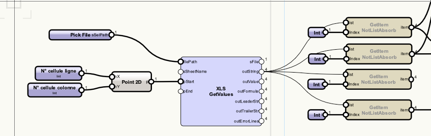

wellebracht Posted March 4, 2024 Share Posted March 4, 2024 Hello! So, I'm trying to create a Marionette system to grab data from an Excel from a particular row, grab that data into a list, and use that list to create/duplicate/rename Sheet layers, design layers, and worksheets. I have the design layer and sheet layer side if it working properly, but I'm a little stuck on the worksheet part. There are some nodes I have found to select symbols, or duplicate objects, but none of them seem to grab a worksheet handle (i know a worksheet is not a symbol, but i tried anyway). Anyone have an idea on how I can accomplish the remainder of this task? Quote Link to comment

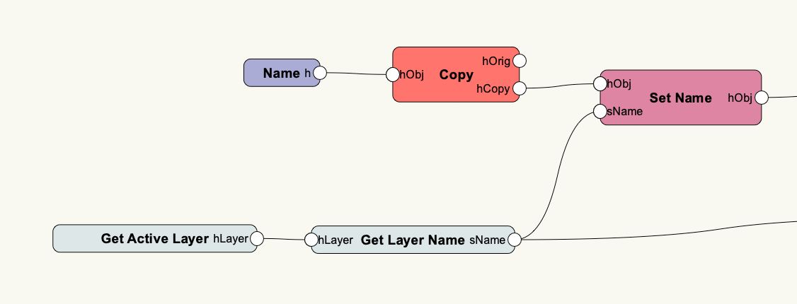

bcd Posted July 1 Share Posted July 1 Yes, that's what I'm doing now, but I'm trying to have that step built into a marionette network. More time for tea! Quote Link to comment
Pat Stanford Posted July 1 Share Posted July 1 I missed that this was Marionette forum. GetResource node should give you a list of all the worksheets in the file. Then you should be able to filter that list to get the one one want and then use DuplicateObject to make the copy. Not sure about the rename, but should be possible. Also not certain what input you will need to vie GetResource to have it return the worksheets. Sorry Quote Link to comment
bcd Posted July 1 Share Posted July 1 Yes, I tried Duplicate Object. It will work on a Worksheet image that's placed in the drawing already, but I can't get it to work for the Worksheet itself in the RM. The naming part is working well though using the Set Name node. Quote Link to comment
Pat Stanford Posted July 1 Share Posted July 1 The Duplicate node uses the CreateDuplicateObject Vectorscript function. That will not duplicate resources. You will need a node that uses the HDuplicate function instead. It would be fairly easy to create. But it is likely that the script for the node would be longer than a script to duplicate the resource directly. Quote Link to comment
the frog Posted July 2 Share Posted July 2 Are you looking for DomC node ? Easy to use fast and great ! Quote Link to comment
Marionette Maven Marissa Farrell Posted July 2 Marionette Maven Share Posted July 2 The Copy node uses HDuplicate. You'll need to use a Set Name after to name the new worksheet, otherwise it won't create a new resource. I'll make a note to try to handle that better. Also - the copy node is cool because if you don't wire the output of the copy node to something else, a copy won't get made. I'm not sure if that's beneficial in this case, but when I was looking it over, I saw that's how it's implemented. 1 Quote Link to comment
bcd Posted July 2 Share Posted July 2 Perfect @Marissa Farrell thank you. Yes, already had it naming the new ws so now it works a treat. Quote Link to comment
