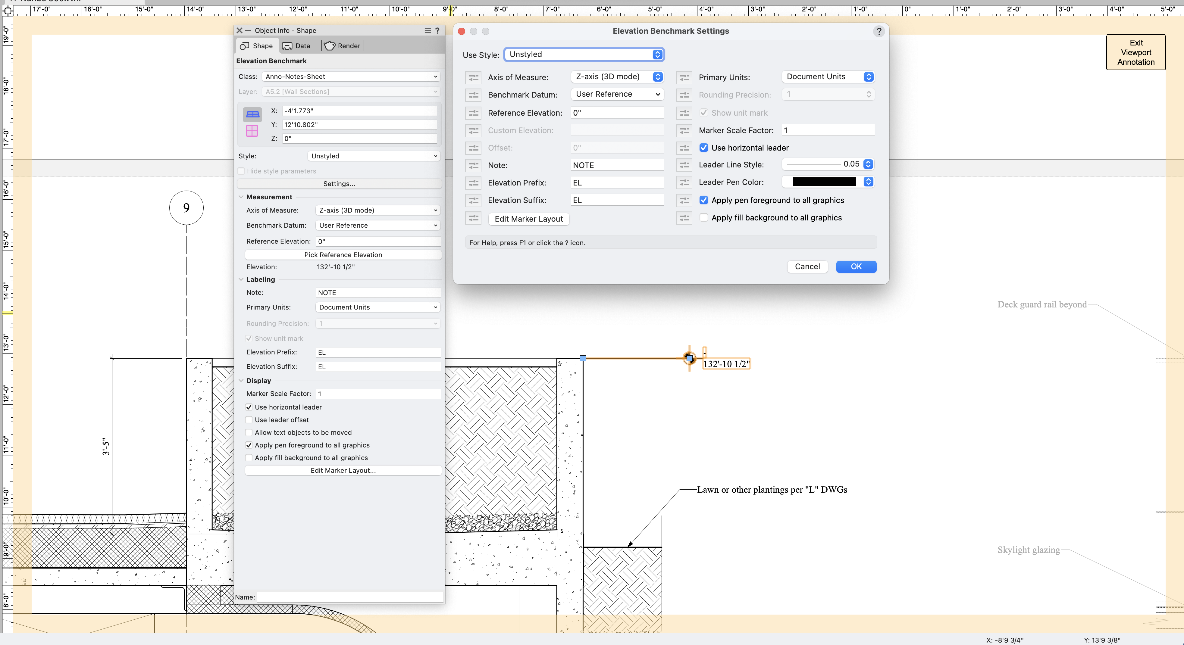

Hi all. When I place a Benchmark, the OIP seems to indicate that a Prefix, Suffix and Note should be appearing but they're not. A "-" does appear but I don't see that in the OIP. In the past, I was able to use these fields. Does anyone see what I'm doing wrong? (Screenshot attached). I'm in VW 2025, using an 2021 iMac w/ OS Sonoma. Thanks, Ed

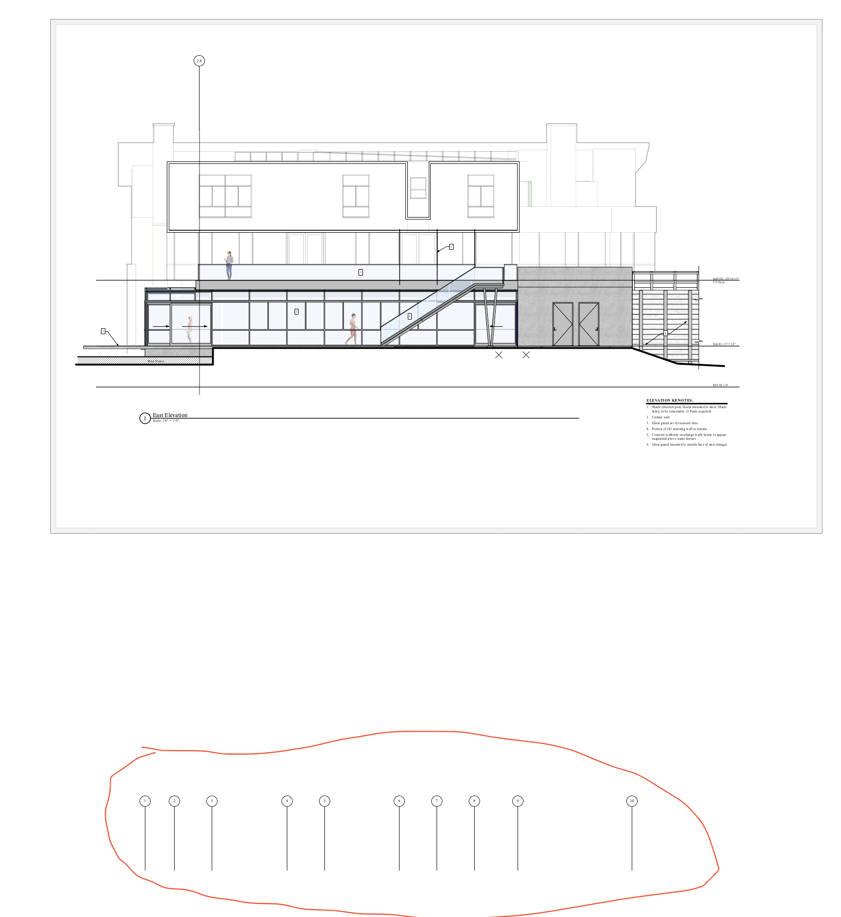

Grid Lines appear off the sheet in Section Viewport
Ed Wachter replied to Ed Wachter's topic in Architecture
Yes! Removing the Grid Line instances from that VP and then adding them again resolved the issue. They re-appeared at a length determined by the VP crop. I was then able to grab the ends and drag them to my desired length. Thank you all! Ed -

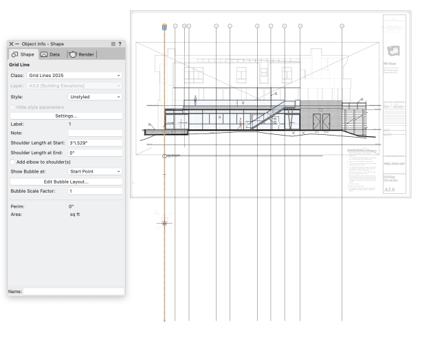

I can grab to the top ends and drag them onto the drawing, but I can't drag the bottom ends. The "Shoulder Length at Start" shows the correct line length. The "Shoulder Length at End" doesn't seem to do anything; the lines don't change regardless of what number I enter. When I attempt to move the lines an error message says that the position is locked. Are they un-lockable? I'm new to using Grid Lines. I'm still stumped. Ed -
Hi all. How do I get these grid lines positioned where I want them. All of them, except one, appear off the sheet. This example looks like an elevation but I'm using a section VP. Please help if you can. Thank you! Ed
