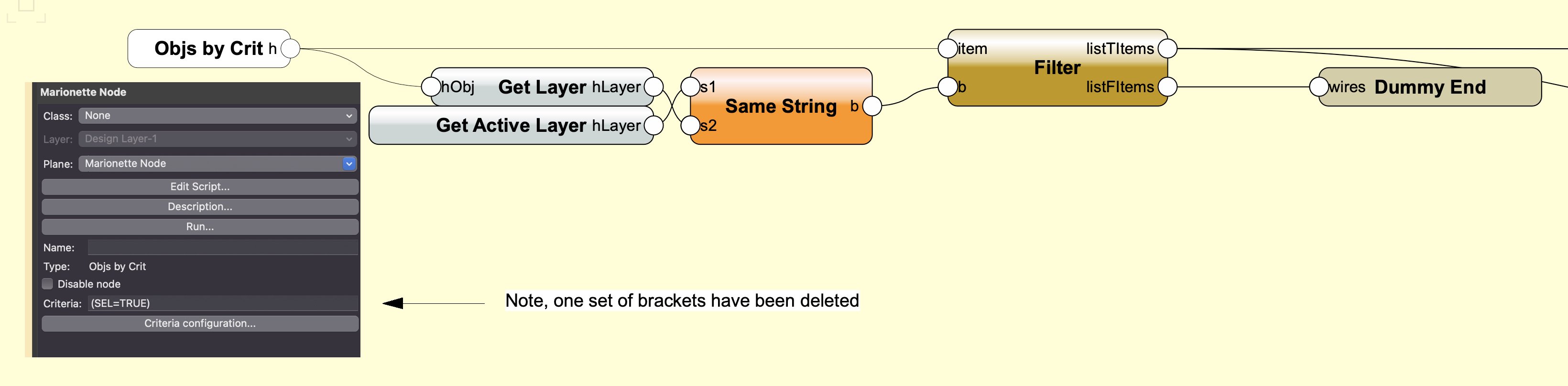

menu command problem with object by criteria SET=TRUE
gplumb replied to Etienne Azambre's topic in Marionette
I have been using a workaround to get object selection to work via menu commands. it still has an issue, that it will not run correctly when inside groups. -
