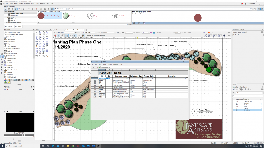

  5. I have a report which is showing a plant which I can't see or find on my plan.  I'm not sure how to get it out of there so I can clean up the report.  You will see Plum Pudding Coral Bells.  Thats the one that needs to go.  What do I do?
