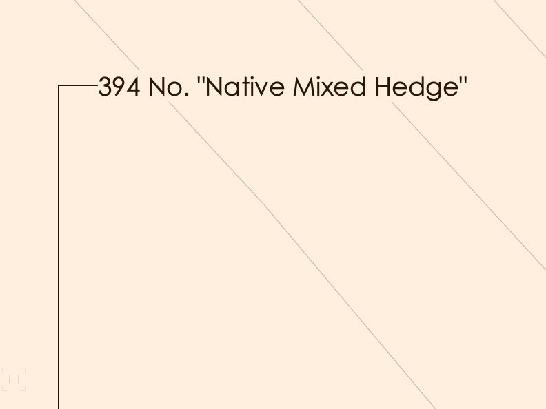

Trying to make a mixed native hedge with 9 plants, but hitting a wall at 7. It seems this is the maximum number of plants I can have in a hedgerow. Can this be changed? Maybe 15 or so just to catch everything.

Thanks! #OSTYLE# gives me the style name without the inverted commas
