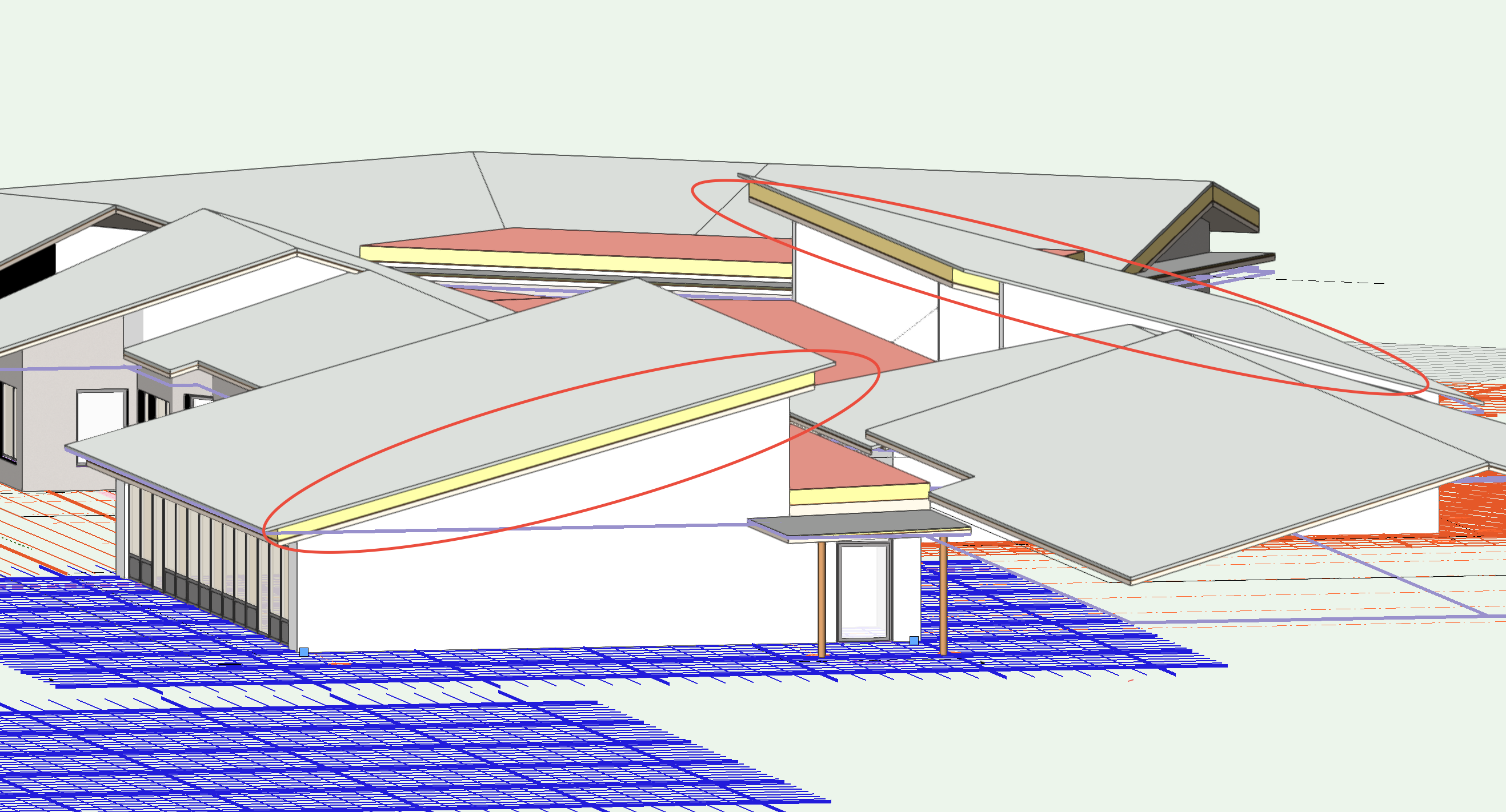

Continuing my exploration of 3D modelling (but still being pressed by time to deliver my project...), I have a "few" questions about wall and roof interactions.
We are renewing and extended a school, which has already been extended several times, so the existing roofs are a mess (see figure 10 for my 3D modelling). I used only roof faces for the modelling as the shapes are too complicated for a complete roof.

I have the same problem with the roofs of the school, see figure 12 (look at the red ovals). On both cases, roof and walls are asscociated. But the components of the roof faces do not stop at the same place.

@A2M, yes I've done the "stack multiple roofs" scheme - that was sort of the "old skool" approach but was reliable if not a little hard to manage.  The current roof just doesn't seem to be able to deal with "real world" scenarios - in very simple designs, it seems to be able to cope but anything more than VERY simple constructs, it just seems to fail.
Personally, and this is MY opinion, I would use the roof/roof face as a conceptual tool (probably with few or NO components but at the correct overall thickness) and then draft the details/connections that I need in 2D.
