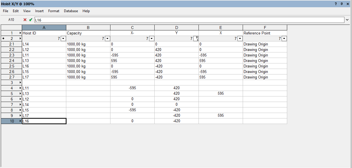

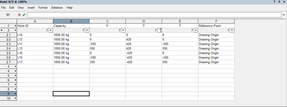

I've not gotten so far as to actually have anything in a file that is not already in a blank document. This is a blank document with 3 hoist objects put in, nothing else. I would love to map the "function" field to fill based on what layer it is on for example, but im just trying to get started somewhere. Im mostly curious as to why "parametric object - hoist" fields are not definable nor mappable, and why criteria based ((PON='BrxHoist')) says no objects found, when it actually does find objects when editing the criteria! I've found that there isnt really much information regarding WHAT you can do with the tool, as in different use cases, or maybe im just bad at looking.

Is Hoist objects limited in the Data Manager in VWX2026? Im trying to learn how to do some automatic mapping and making custom datasheets, showing only the information i need. Very new to using the Data Manager at all, so any tip is welcome! Cheers Using "parametric object - Hoist" Gives everything, but mappings and conditions are greyed out. Creating a criteria based mapping, finds 3 objects in the criteria dialog, but nothing in the data sets window
