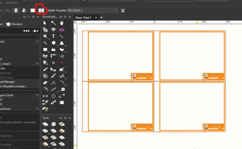

  7. Hi, i can insert one title block on an empty layout as a symbol. That works fine. But is there a way to insert multiple title blocks on one layer via script? Something like using the title block command with multiple title blocks: And hiw about this?
