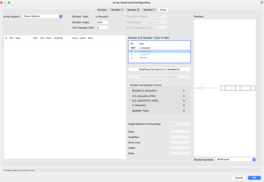

  2. You are correct! I suppose that limit is selected just to conserve resources and processing time? Anyway, that did the trick, thank you so much! Can I also add another challenge? I'm trying to add the speaker arrays to this but the only thing that shows are the "bumpers", not the cabinets below. Attached is a screen shot of the array config. Any thoughts?

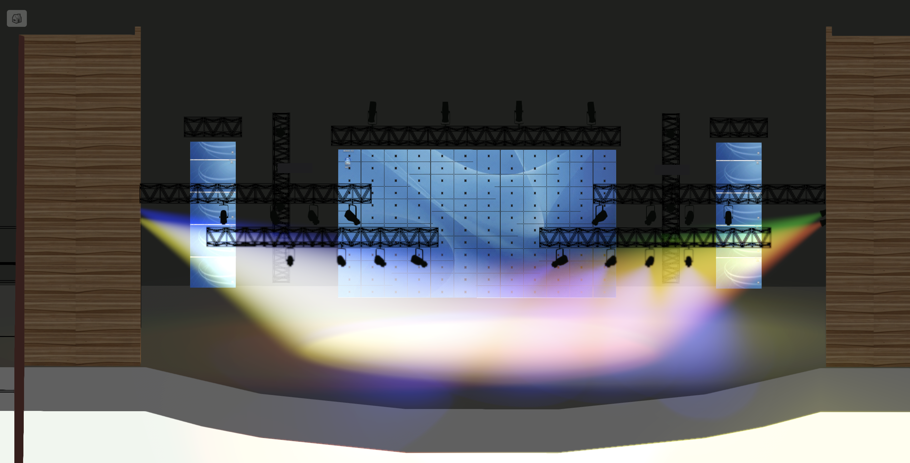

  3. I'm new to Spotlight, but I have created this stage with lighting and can only "turn on" and adjust 4 fixtures at a time. In the attachment, only the fixtures on the right truss are on. No other fixtures can be turned on, unless I first turn these off. Being that I copied and pasted the fixtures initially, is this due to them not having unique addresses or names? Secondarily, I can't seem to always adjust the colors correctly? Those 4 fixtures are set to be "white", not blue. But this may be the result of the above problem?
