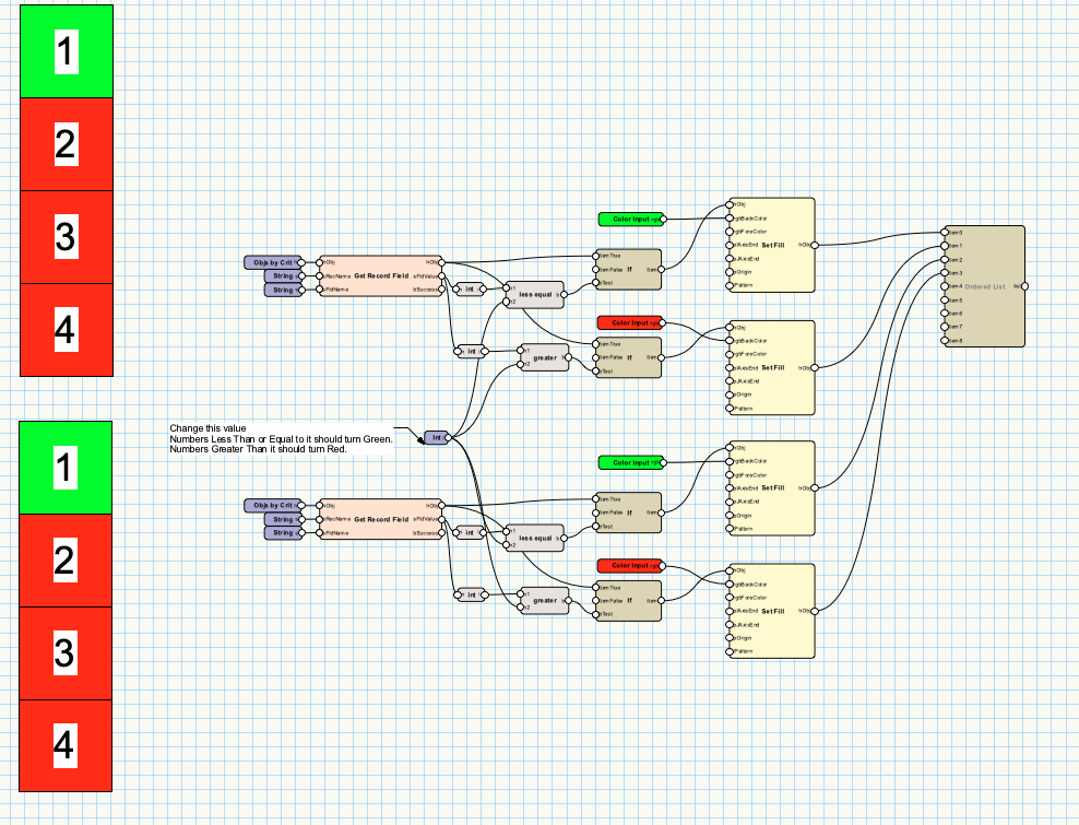

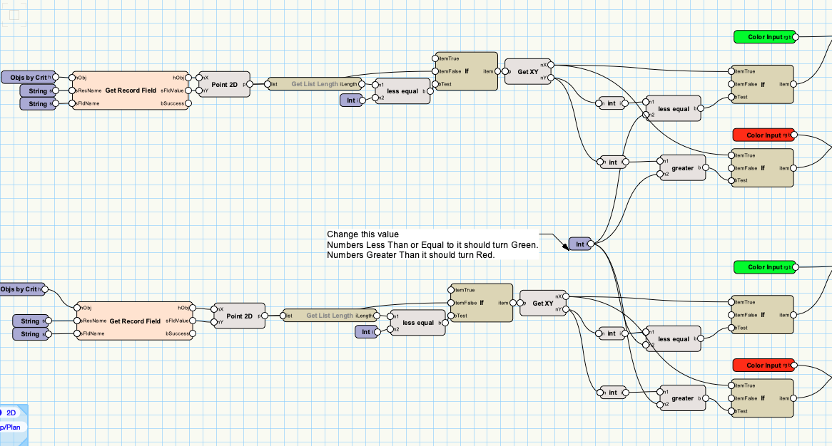

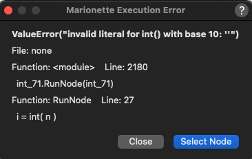

After messing with it for a bit, I think I did find a way to avoid it, but I'm not looking forward to retro-actively doing this on my 4,000 node network. I added a wonky count function to the script. If anyone has any alternatives (or just a setting to make the errors not appear), let me know! Otherwise, I'll start adding this retro-actively to my huge network next week 😅
Hey Forums! I have a complex marionette network now (Over 4,000 Nodes!) and it does work; however, I get this error that pops up and I can't figure out a way to avoid it. I am attaching a much smaller example (in 2025 format) to hopefully figure out how to avoid this. I'm pretty confident the issue is that part of my script can potentially pull zero results. Setup: This script would ideally become a single button/node once wrapped. Top 'Objects by Criteria' looks for anything with "ExampleRecord" attached. (the top 4 squares) Bottom 'Objects by Criteria' looks for anything with "ExampleRecord-2" attached. (the bottom 4 squares) Steps: 1. If you change the INT value to 3 and run the marionette, you will see it works fine, no error. 2. Delete the bottom 4 squares on the left (you will not have no objects with "ExampleRecord-2") and change the INT value to 2, and run it again. You will now get the error I'm trying to eliminate, but the script will still work (the squares on the left will still update as expected). Any ideas on the best way of avoiding this? ErrorTesting.vwx
