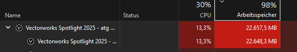

I believe Vectorworks is leaking memory.
Quite often when I just change the view in hidden line mode it just eats more and more memory, until I get OOM errors in Windows.
a minute later
I'm wokring on a 200 mb ifc file, each import takes 2 hours.
My vwx file is only 270 mb, the project just started.
I'm clueless how to continue, all my drivers are current.
