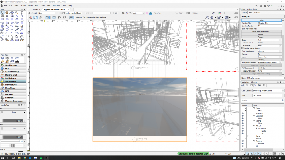

Tijn Posted November 28, 2021 Share Posted November 28, 2021 Hi im trying to render images but it randomly seems to render seetrough and now I cant get it to render normaly I hope someone know whats going on, im probably doing something wrong... Quote Link to comment
0 trashcan Posted November 29, 2021 Share Posted November 29, 2021 Looks like your objects have some sort of transparency attached to them: To rule things out: Try a different render mode! Try a different angle! Turn off class overrides! Good luck Quote Link to comment
0 Hans-Olav Posted November 30, 2021 Share Posted November 30, 2021 Just guessing but you also might have some layers set as grayed in the viewport. Grayed layers render transparent 1 Quote Link to comment
