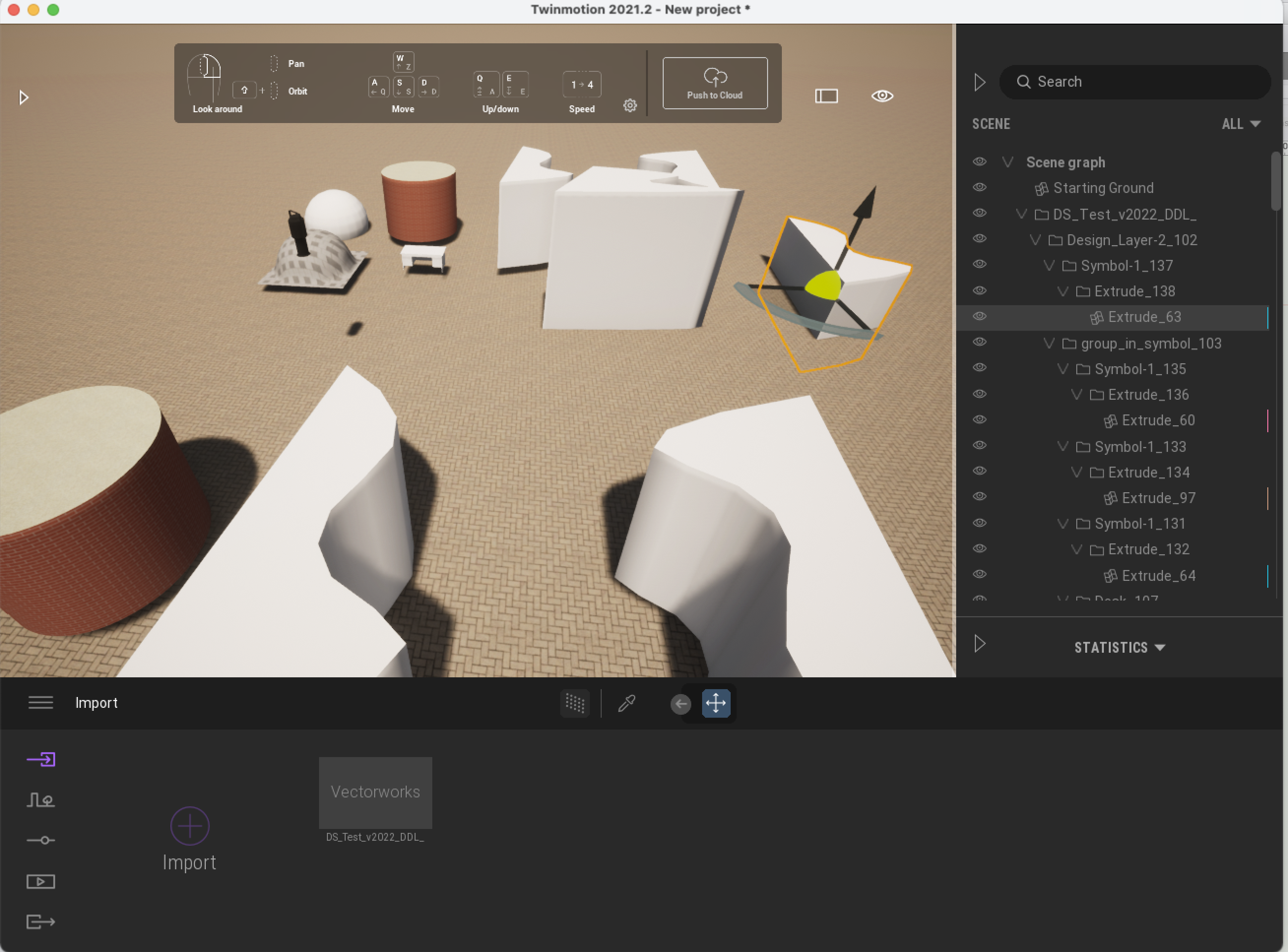

0 Vectorworks, Inc Employee dlopez-gutierrez Posted December 2, 2021 Vectorworks, Inc Employee Share Posted December 2, 2021 In this case what Twinmotion version you are using matters. We coordinate with the engineers from Unreal to enable features in both Vectorworks and Twinmotion. the new features that we added to SP2 are not working with previous TM version I open your model with VW 2022 SP2, and the model is synchronizing correctly with Twinmotion 2021.2 Upgrading to TM 2021 should fix the missing geometries issue. Please Let me know if you are still having problems after that 2021-12-02 12-14-03.mp4 2 Quote Link to comment
