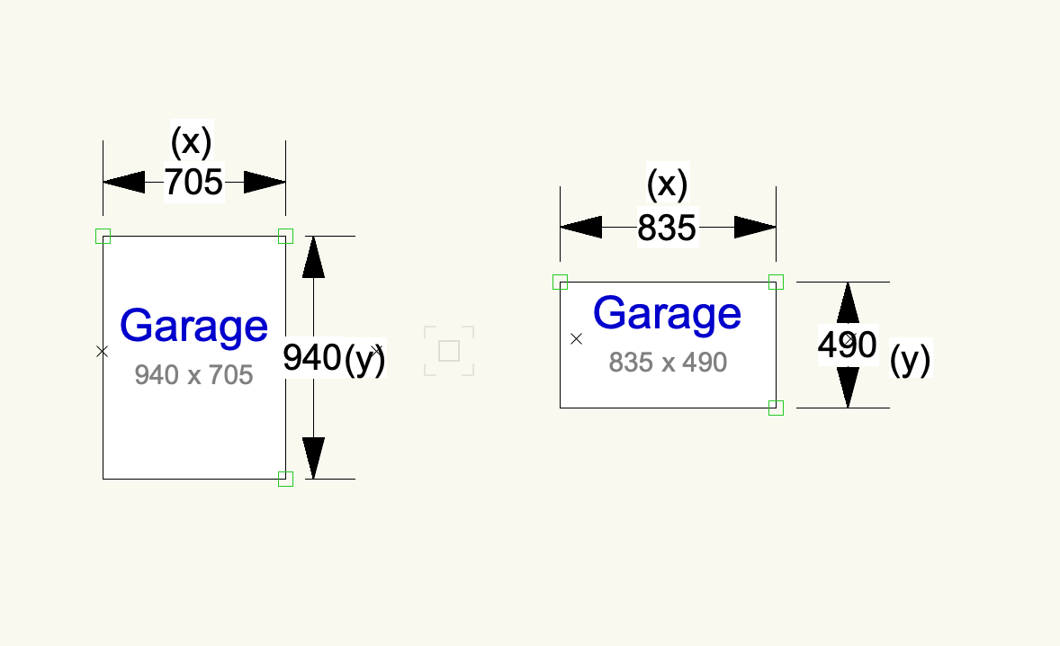

Extracting room dimension extracts length x width of a space.
"length as the longest side of the space
I would like to have the label to be consistent, i.e., if show the dimension in 'x' distance and 'y' distance and not length and width
Attached a screenshot for clarity
For now, I'm setting up two custom Space Label one has Width x Length and the other has length x width and assign it manually based on the geometry.
If there is a way to automate this, it would be helpful. Thanks!
