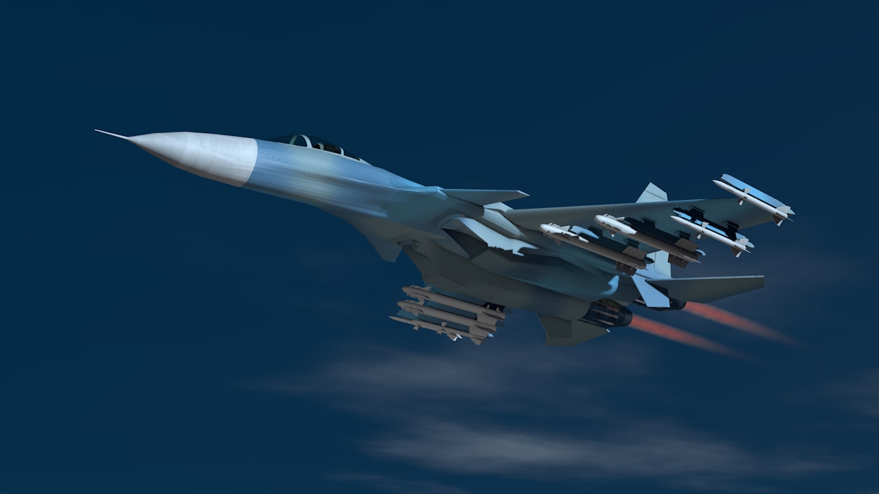

VIRTUALENVIRONS Posted May 4 Share Posted May 4 (edited) A lot of the simpler models I show are printable or machinable. The jets are a different story as they have to be animated, landing gears, etc. NURBS are NURBS, simple as that. Whether it's Rhino NURBS or VW NURBS, all the same. The two large tutorials recently released were directed by Vectorworks as a teaching tool. Not sure exactly who for, but a teaching tutorial. I have been in conversation with Rhino on SubD. I sent them some models and asked some questions. I always saw Subdivsion modelling as part of a tool box and that is the way they see it. So, they commented on two models, both are below. The mouse they would build the body with SubD only and then convert to NURBS to finish. The Jet would be be built with NURBS Surfaces only. Now, some other Rhino designers might change that up, but I don't see why. Just caught your last post Jeff. Again, it wasn't so much about the end product as showing as many methods as possible in two twenty five minute tutorials. It is what theY asked for and that is what I delivered. They viewed each step of the way. They could have had the mouse or jet below, but they wanted the pulley wheel system for some reason. I can understand the chair. Edited May 4 by VIRTUALENVIRONS Quote Link to comment
