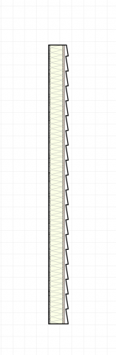

That's a really great video @Matt Panzer thank you. So if I became really obsessed + wanted to depict super-realistic featheredge cladding (bevel siding) or vertical batten on board siding for that matter I could use this technique? To just remove material from the outside face of the wall. And would this give me the correct profile in each case in top/plan + vertical section?
Thanks again lots to try out...

I often work with older buildings + had been wondering how best to bend VW's neat straight lines to the more organic surfaces I'm looking at. Your wall hole tip Matt is great + I'm sure there are many circumstances I'll be looking at how I can use it. For example here I've used it to create a cornice + angled plinth in a brick wall:
865388660_Screenshot2020-10-13at07_57_31.thumb.png.34949ae05b53f153174589caa9be151e.png
119279123_Screenshot2020-10-13at08_01_20.thumb.png.b6f6a32221cf4870aeb23237295b7ec1.png
I was assuming I'd need to model extrudes + apply them to the wall surface but this is a far more satisfactory method.

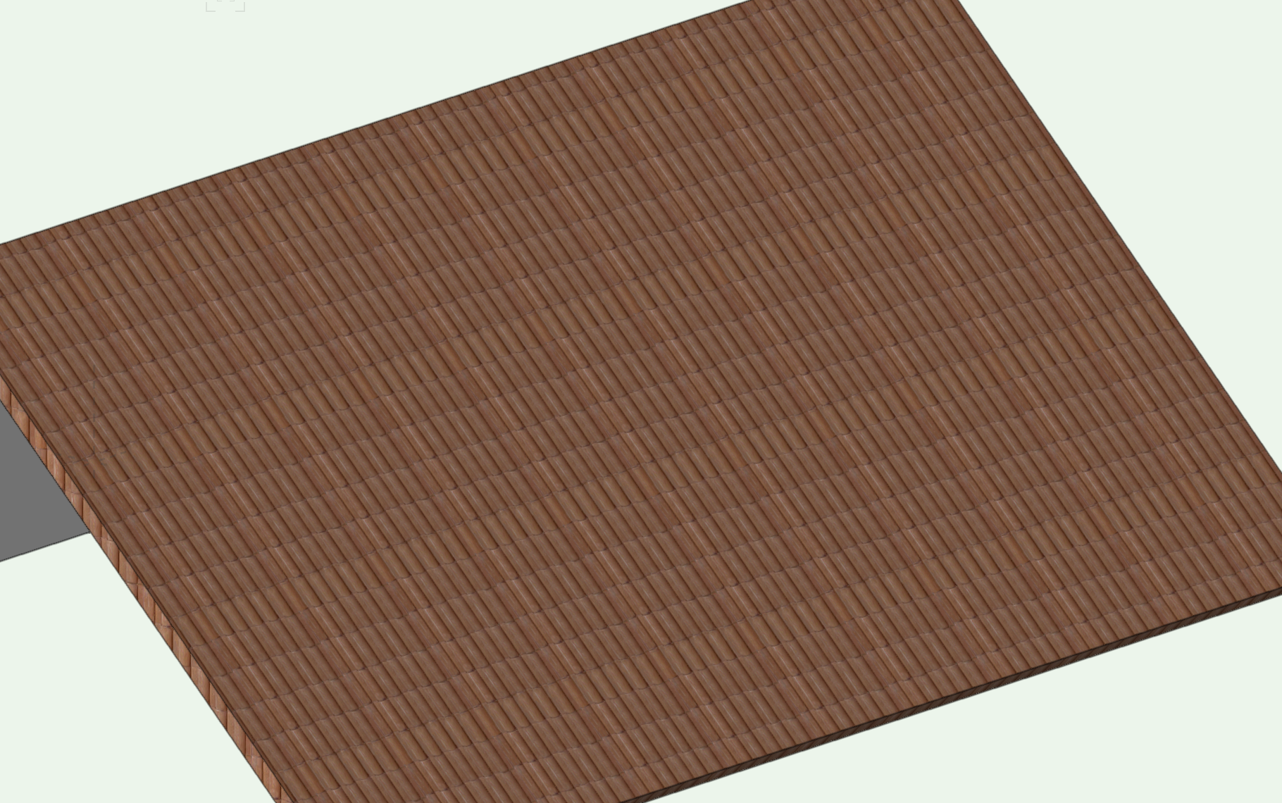

Hi @Matt Panzer I believe this wall hole technique should work on Roof objects as well as walls but I can't get it to happen - would you be able to help?
This is my roof:
1649946452_Screenshot2020-11-24at05_53_43.thumb.png.4ebcba893c2697b637cfa7208860ad00.png
And this is the wall hole symbol I made + was trying to apply to it:
675438446_Screenshot2020-11-24at06_19_11.thumb.png.340f9ccf2241d7fc978e402c9785bfe4.png
I can insert the symbol into the roof as you would a skylight but it has no effect in the model: it doesn't clip the surface.
But then when I've looked at various skylights in the libraries to see how they're set up I've realised they don't even possess 3D Wall Hole Components so now I'm really confused. How in that case do they clip the roof?
This needless to say is what I was trying to achieve (done here as a solid subtraction):
2065042060_Screenshot2020-11-24at06_46_57.thumb.png.19fb806cc0f4ab291bb98746aab3df51.png
Just an experiment but any guidance appreciated
Many thanks
Tom
  • Like 1
Link to comment
  • Vectorworks, Inc Employee
This is my roof:
Many thanks
Tom
Hi Tom,
Unfortunately, Roof and Roof Faces do not use hole geometry from symbols.  However, Slab objects do (when the symbol is placed in its slab modifier group).
Holes for skylight symbols in roofs are automatically created to the 3d bounds of the symbol.  We realize this is not ideal.
Link to comment
