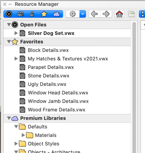

Guest Wes Gardner Posted December 8, 2020 Share Posted December 8, 2020 @alex.fitch, you can also use the "Favorites" concept to organize details. The Resource Manager is an EXTREMELY powerful tool in Vectorworks. I suggest that everyone in your firm learn its abilities inside and out. Wes Favorites Files.mp4 Quote Link to comment
genie Posted December 18, 2020 Share Posted December 18, 2020 @Wes Gardner Curious as to why you separate each detail category into different files vs having 1 main detail file with the categories separated by layers and then by folders in resource manager? Quote Link to comment
Guest Wes Gardner Posted December 18, 2020 Share Posted December 18, 2020 @genie - I really just wanted to show that you CAN organize details in this manner...you should do what is the most comfortable for you and works for you and your firm. Wes Quote Link to comment
