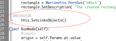

m.graf Posted December 10, 2020 Share Posted December 10, 2020 (edited) Hi axhake have you tried to delete this under BEHAVIOR (but only in all node's you need for your Menu tool) greatings M.Graf Edited December 10, 2020 by m.graf Quote Link to comment
