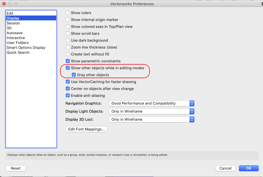

Christian Fekete 17 Posted November 6, 2020 Is there a way to change the white lines (invisible +/-) of objects visible while in editing mode? ie group editing, so the is is possible to snap on visible objects? Is it a new version issu? could see that in previous versions Quote Share this post Link to post
Taproot 238 Posted November 7, 2020 I think this is what you're looking for - Located in the Preferences: 1 Quote Share this post Link to post
Christian Fekete 17 Posted November 7, 2020 Yes this is the option to allow to show these objects. I am wandering if we can change the color from gray which I cannot see because it blends with the background. Thank you Quote Share this post Link to post
Tom W. 151 Posted November 7, 2020 Doesn't unchecking 'Gray other objects' achieve what you're looking for? Quote Share this post Link to post
