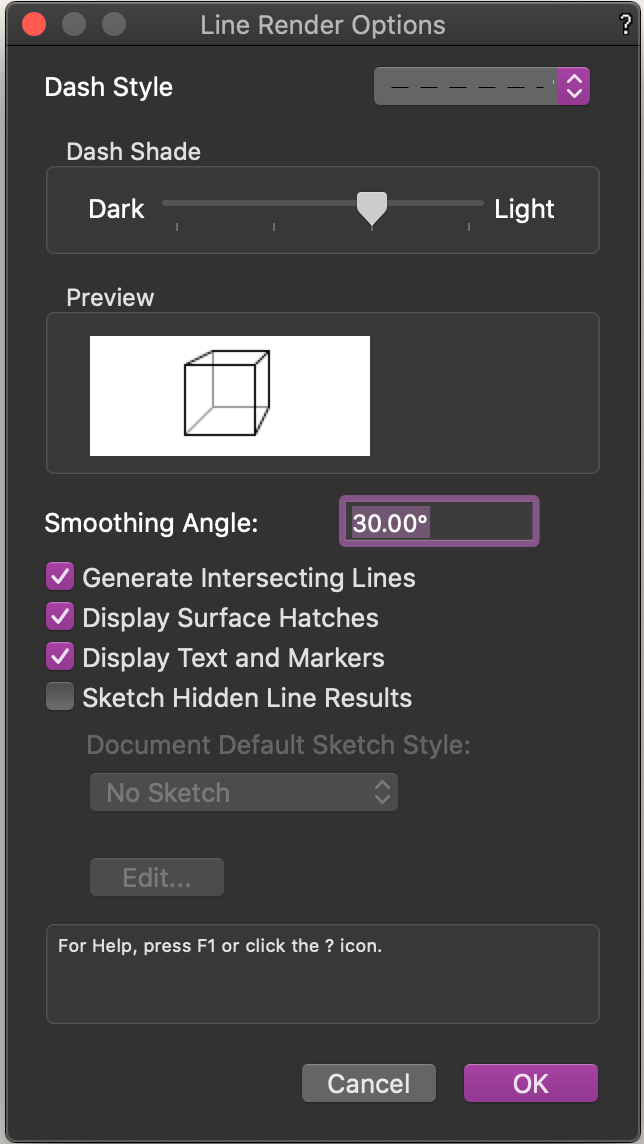

Go the the Line Render options and make sure an actual dashed Line Type is selected (where it says Dash Style). If you're not seeing dashes it's possible that "Continuous" is selected.
1337004272_ScreenShot2020-10-22at8_36_06AM.thumb.png.2d89b59854454cd5dec0b2a69996bf03.png

^ this is the likely culprit. What version of VW are you using? There was an issue where the default line type was set to continuous after a SP upgrade in the past (VW2020). Perhaps its happened again.
