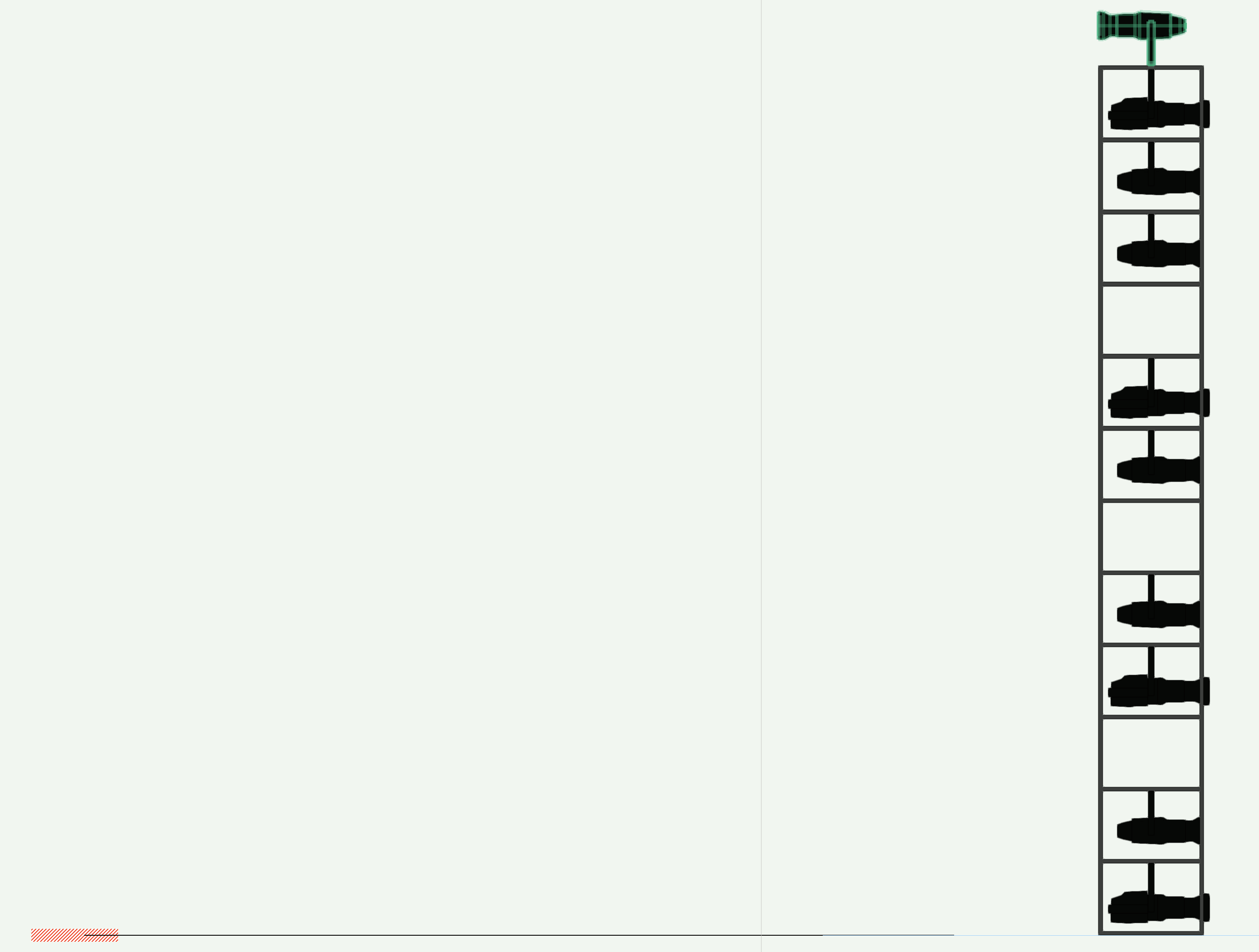

I have attempted to use the schematic tool for booms for the first time.
Yays:
  • It's an easy tool to deploy
Boos:
  • having to make an array of fixtures sans c-clamp & moved up to accommodate new hang point on fixture (entire ETC Source Four catalogs for ex)
    • (do I really need to do this? or am I missing something, as I am wont to do)
  • Having the Schematic render a fixture such that it requires much fiddling to make it align with all it's other position sibs [see attached pdfs & vwx file - what is that red band which I cannot make go away, unless I restore the default rotation of th3 schematic)
I feel reasonably confident I am missing something fundamental here. Any assistance gratefully accepted.
Included is the vwx file as well s some output pdfs and screenshots.
My profile shows my M1 MBP stats, I am updated to latest VWX svc pack 5

Its actually quite simple to solve and is all to do with how the geometry sits inside the hanging position.
I made a video about a year ago. You can find a direct explanation of your use case at 6 mins in.
  • Like 1
Super, Thank you @markdd, I'll check it out immediately
