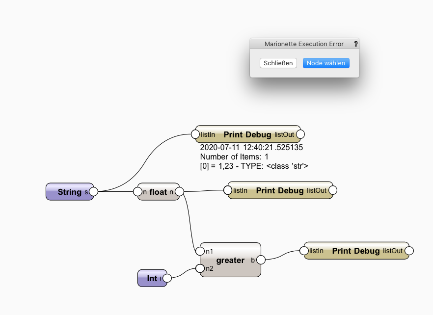

the real problem:
the cell value in the old "get cell value node" is a string with "comma" like  "1,23"
the "float node" only converts strings with Dezimalpoints like "1.23" to numbers
But the script stops at the first node with the error message,  so it is difficult for the user to find the error.
greatings M.Graf
