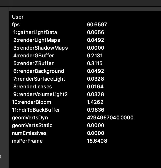

bbudzon 119 Posted June 17, 2020 15 hours ago, fuberator said: still the same behaviour That is unfortunate... let's try gathering some more information. Can you launch Vision to an empty file, click into the Scene Graph Dock and press the 'o' key once. This will spawn an FPS counter. I'd like a screenshot of this. I believe if you press 'o' one more time, you will get even more detailed diagnostics. A screenshot of this as well would be nice. I'm just curious as to how well your machine is performing in an empty file as it should be pretty darn fast. If we can confirm that, perhaps the UI is "lagging" for some other reason? Quote Share this post Link to post

fuberator 13 Posted June 17, 2020 I understand now. Never noticed there were three preferences. A bit confusing with two already 🙂 Also I had not clicked in the scene graph, sorry. Now i get the fps. Empty document, nothing except chrome running: I do not have the tool selection bug on my laptop which is also running catalina. It must be specific to my system on that 6,1 machine. Vectorworks is also giving me grief on the same machine which I have detailed in another post Time for a wipe perhaps Quote Share this post Link to post
bbudzon 119 Posted June 17, 2020 60 fps is pretty darn good and what I expected in a blank document. Odds are, VSync is capping you at 60fps (VSync is actually really good to leave on). The point being, 60fps is MORE than fast enough to avoid "blocking" the UI. So, it seems the issue you are having with tools is unrelated to renderer performance (because again, 60fps is more than enough to avoid lagging or blocking the UI). I haven't seen your VW post, mind linking it?? FWIW, I do not think this is specific to OSX Catalina which you've confirmed with your other machine. I'd hate to have you wipe it, but if other programs are giving you issues as well it may be necessary. Quote Share this post Link to post
