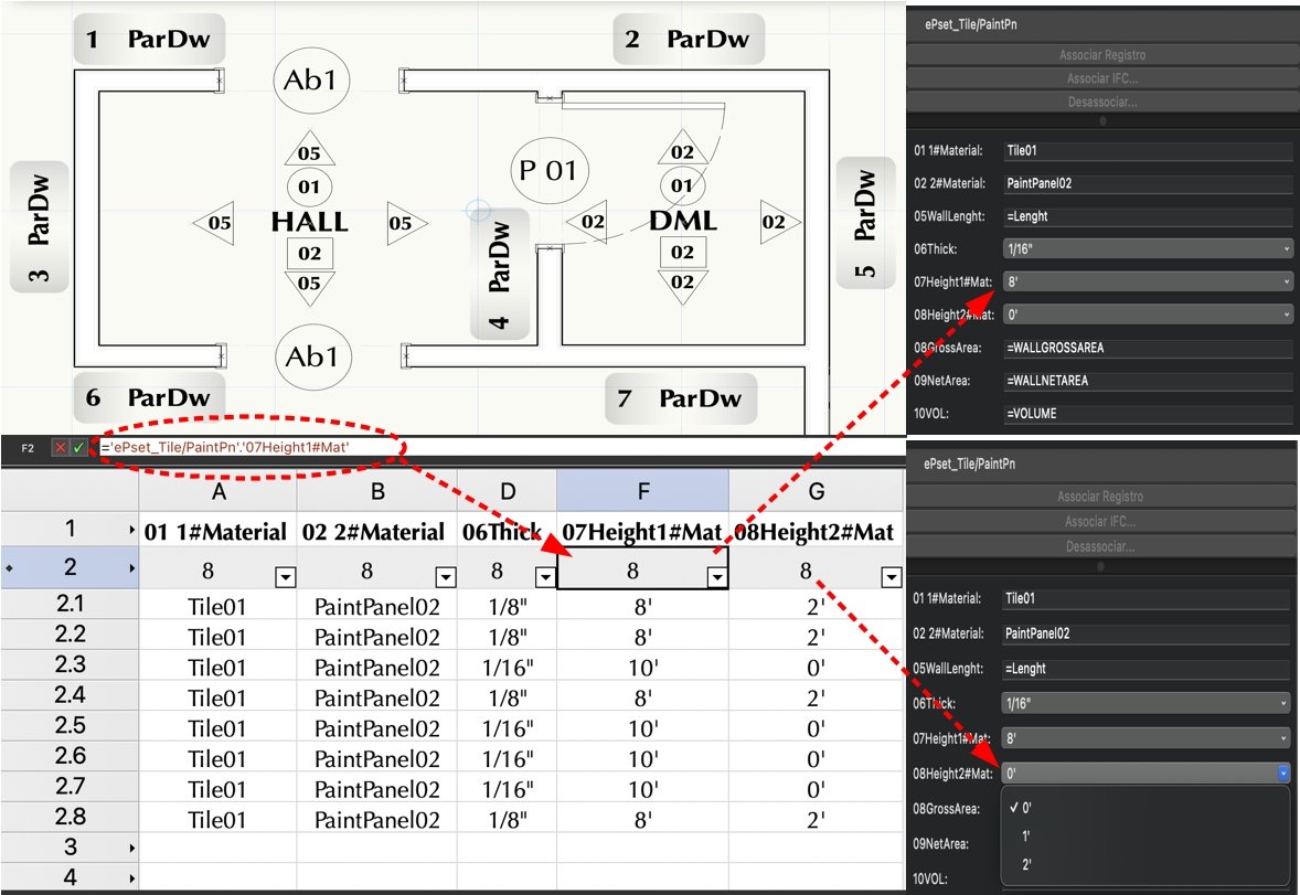

Silvano Mainardes Posted July 17, 2022 Share Posted July 17, 2022 While we don't have a function like that, I make a record format with the heights for the cladding(s) and attach it to the wall style. I consider two coatings of the same or close thickness, with different heights, as the same component. In the wall instances in the drawing that have identical heights of these coatings, in the OIP, I select the record format in the data tab. Then, I modify the correct heights there and update the report for this component composition. This isn't the best BIM solution, but the VW returns exactly and precisely the determined heights. The render is another problem, with another tasks. Quote Link to comment
