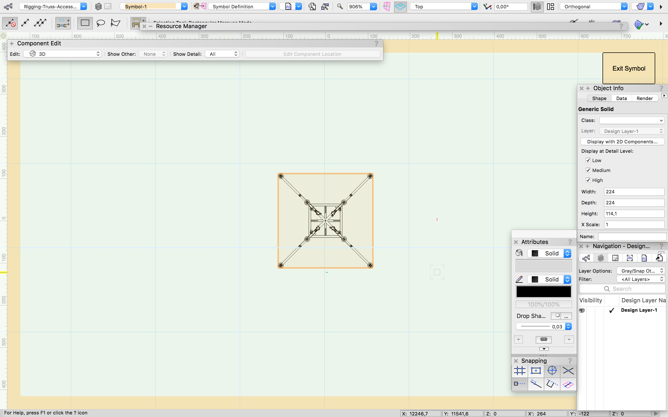

Sometime back, there was a change in the way one edits a 3D symbol.  I often find myself wanting to edit 3D symbols and typically this involves using some 2D geometry to create new or modified extrudes or simply drawing lines for registration purposes.  The relatively new development (seems like the past two or three versions) is that any 2D elements immediately move to the 2D component of the symbol unless you change your 2D drafting plane to "symbol definition" or (I think) "screen plane".   I would really like for the default for my symbol editing to be "symbol definition" as there are next to no instances where I would ever, while editing the 3D portion of a symbol, draw 2D geometry that I wanted to immediately disappear to the 2D portion of the symbol.  Every time this happens it is "undo", set the plane to "symbol definition" and start over.  If I do not utilize "undo" I'll end up with an errant piece of geometry in the 2D portion.  Is there a preference specifically for this?

I believe the change was implements so that Hybrid Symbols could have not only a specific Top/Plan view separate from the 3D model, but also custom 2D views for any of the standard Orthogonal (Front/Back/Right/Left/Top/Bottom) views.
