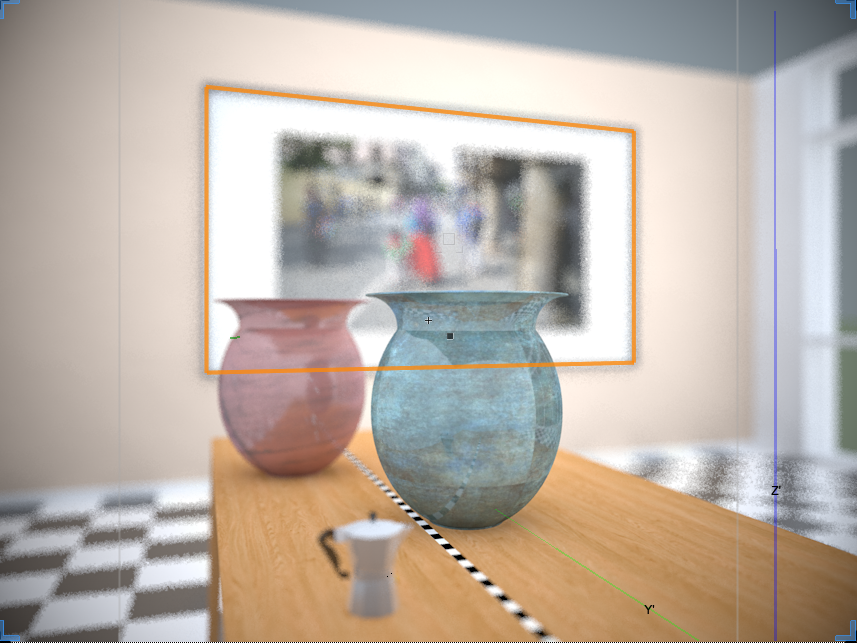

I have my camera selected and active with an F-Stop of 1.4. In wireframe I click "Click to Set Focus Distance" and I select the vase in the foreground. My intention is to have a shallow DOF, focused on the foreground vase. I'm using the cropped perspective view as per the tutorial:
When I click the vase, the Focus Distance reads out as 19'8.982" when in fact it should read 3'4.139"
I know this because:
When using the "Set Focus Distance" from the camera view and it goes to that high wrong number and I switch to Final Quality, I get the wrong results, obviously:
When using the "Set Focus Distance" from the Top/Plan view I get an entirely different number of 4'10.096" - shouldn't this number always be the same or close to the same? In all instances I'm clicking the front of the blue vase. Here are the results I get when selecting the Focus Distance from Top/Plan:
When I manually put in the correct Focus Distance, I get the expected behavior - though the brightness is definitely incorrect. A change in focus distance should not change the brightness of a scene if all of the other settings remain the same...
When I did it a second time, the focus and the brightness of the image were correct. Why's that? Because if you change the settings of a camera, sometimes you have to toggle its activation on and off in the Viz palette... This works as a solution to other render bugs by the way. If you find your renders aren't updating to from fast to final for some reason this appears to be a work-around for that bug too.
