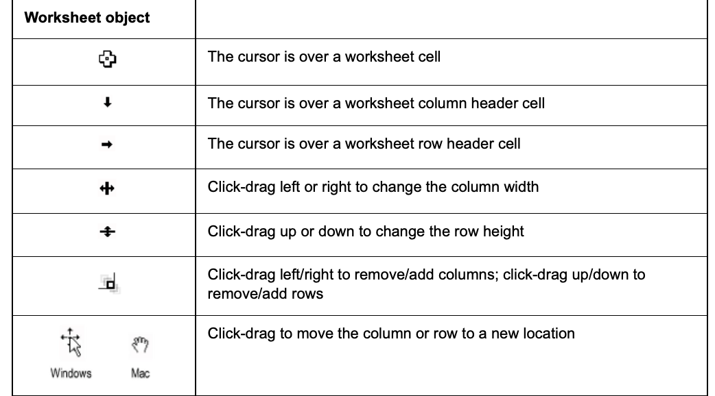

Pat Stanford Posted May 19, 2020 Share Posted May 19, 2020 Hover over the bottom right corner and the cursor wil turn into something that looks like a left facing angle. (it is actually much bigger than in the screen shot). When it is in that mode you can click and drag to add columns. If you see the "block cross cursor" (which I can't find a picture of) you will just resize as you stated. You do need to scroll to the bottom right corner and then you probably need to adjust the window size so there is some blank space to drag into. But it does work. ;-) HTH Quote Link to comment
Pat Stanford Posted May 19, 2020 Share Posted May 19, 2020 Here are some better images of the different WS cursors. 1 Quote Link to comment
