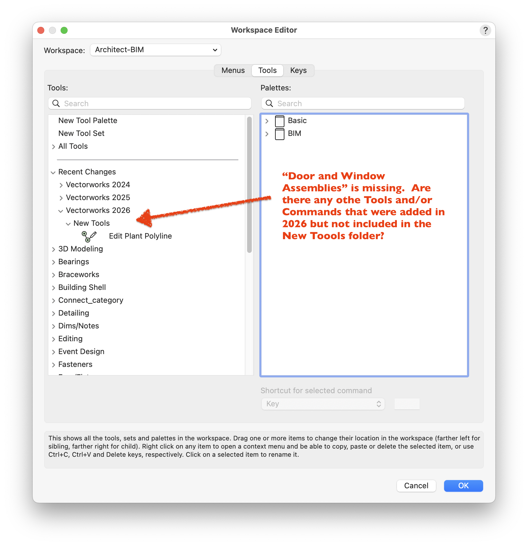

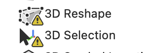

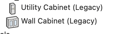

New 2026 Workspace Editor bug.  New tool missing from the New Tools folder.
This is also a good time to ask again to have legacy tools and commands marked as such.  This has been done in a few cases, but it would be very helpful for someone at VW to comprehensively update these names and icons.  I have to guess this is a fairly straightforward task for someone in the UI team (@Stephan Moenninghoff?)
LegacyIcon.png.a247002a6492b0b1e7ef2f5d5d152a4f.pngLegacyTitle.png.f34b0f2930beb8fed5a195f282cd62bb.png
EDIT: By the way, the search function that was added (2025?) to the Workspace Editor is great.
Edited by E|FA
