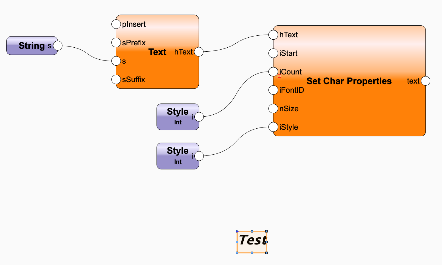

knallfrosch21 Posted February 25, 2020 Share Posted February 25, 2020 hello, as a Marionette newbi I have a problem. I want to be able to insert a text and change the style. A text box also appears, but the text is displayed below it. What am I doing wrong? Am I using the wrong nodes? Test Text.vwx Quote Link to comment
Antonio Landsberger Posted February 26, 2020 Share Posted February 26, 2020 Hi knallfrosch, the text looks good on my end. Are you using the latest servicepack? Quote Link to comment
knallfrosch21 Posted February 28, 2020 Author Share Posted February 28, 2020 Hi we also tested the file on another PC in our office. Everything is going right there. I completely reinstalled the Vectorworks, but the error is still there. Does anyone have an idea? Quote Link to comment
Antonio Landsberger Posted February 28, 2020 Share Posted February 28, 2020 Yes, you could try to reset (rename) the user folder (so Vectorworks sets up a new one). Within the Vectorworks folder settings you can see where it is, both on Mac and Windows. Quote Link to comment
