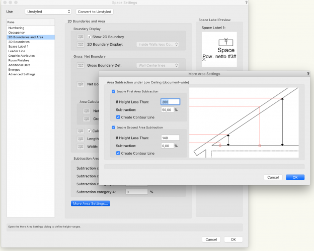

gester Posted February 22, 2020 Share Posted February 22, 2020 hi, is there a way to calculate spaces' areas when there is a space height constraint? in poland there is a norm (and an authority regulation) that the spaces are not counted at all when they have the height lower than 140 cm, the spaces with the height between 140 and 220 cm are counted with 50%, and for the heights above it's already 100% of the space area counted. it is pretty important for the projects with slanted roofs. i've found the space record field value of net volume (counted), but apparently there's no way to divide this volume (and further on for space area) for different heights in order to calculate the spaces correctly. i enclose the v2020 file with one space under the roof... any help would be appreciated. thanks, rob Space.vwx Quote Link to comment
drelARCH Posted February 22, 2020 Share Posted February 22, 2020 Hi @gester Have you tried 'more area settings' within space object shown on attachment? I havent used it myself, but seem like the one you need. 1 Quote Link to comment
gester Posted February 23, 2020 Author Share Posted February 23, 2020 seems a perfect solution, thanks a lot. i've missed this button in the first place 🙂 Quote Link to comment
