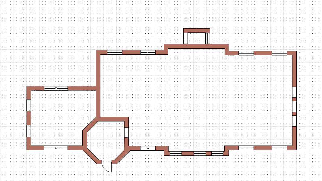

cberg Posted February 12, 2020 Author Share Posted February 12, 2020 (edited) No they don't. This is LOD level - Low. Edited February 12, 2020 by cberg Quote Link to comment

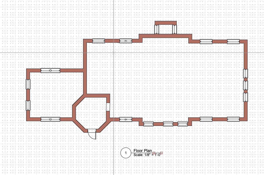

cberg Posted February 12, 2020 Author Share Posted February 12, 2020 (edited) I figured it out. In the Door OIP, in 2d Visualization (even though it is a 3d Element) you have to put the wall lines onto a class that is turned off like "none" or "non-plot". Edited February 12, 2020 by cberg 1 Quote Link to comment
