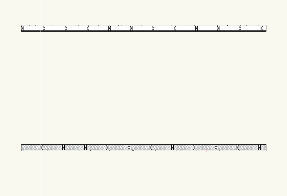

I am setting up wall styles for a project and have created a wall component with a custom tile that represents wood framing.  I was wondering if there is a way to be able to toggle the tile on and off.  There may be times when I want to see the detail and others when I would prefer not to.
I've tried classing the tile object to a separate class, but they do not seem to turn off when the class is made invisible.  Walls do not offer any of the level of detail controls that symbols have.  Is there something I am missing?  Or is this not possible in VW2020?
1875918045_ScreenShot2020-02-06at1_45_45PM.thumb.png.7357635f6e41daef7d29e1689caf14a7.png

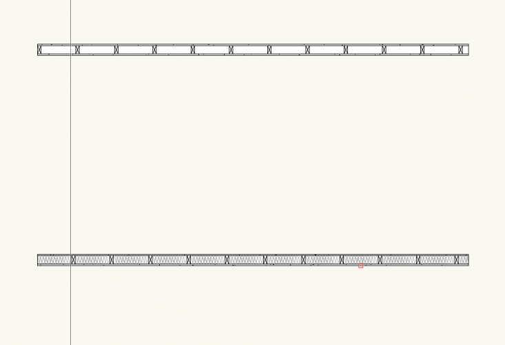

Nevermind.  I figured out.  If you class the component in a structure class, you can turn the whole class off and the structure will go away (including the tile fill)
