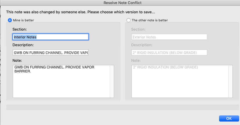

Sometimes there is a conflict between two notes, and an error message appears.  The message says something like, "This note was also changed by someone else. Please choose which version to save..."  No matter which option you select, you cannot fix this problem without finding the conflicted callout and deleting it.  Maybe somebody else knows how to fix it.  I've asked this question for years, and nobody at Team VW seems to fully understand this functionality.

It would be useful if there was a way to highlight the conflicted note so that we could know where it is.
1821898842_ScreenShot2020-11-12at10_32_42AM.thumb.png.72e1226e92f0d98a7b1f13845ad9fc98.png
This is the error message that I can't resolve.  And nobody at VW seems to know how to resolve either.
