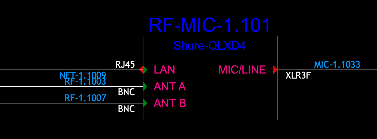

Hello all, I am a previous CC user and just got transferred over to the new VW license today.
Has anyone ran into an issue of not being able to move the cable type tag away from the device? On the "source" side it gives me the move option to move the text out. However on the "destination" side I am not getting an option to do so (typically the little blue box pops up).
Thank you in advance!

Hi Collin,
You are right, we had to remove the control handle on the destination side because in the case of arrow connections across layers it would appear on the wrong layer. I can see that this is causing a problem and I think we have to address that ASAP. Bug-listing this as we speak.
I don't think we can restore the control handle. That issue has to do with how this kind of object works. So... Would it work for you if the destination arrow lengthened automatically to accommodate the all the text in a nice way?

Is anyone having issues with the connect tool reversing the connector type and cable number on one side of the connection? One side has cable number on top of line and the connector type on the bottom, the other side is reversed (please reference screenshot).
@Conrad P - has there been any movement on being able to get the cable type on the destination side of a tag fixed? I still am having the issue from my last post where all the labels on the destination side pile on top of each other.

Basically what's happening is that the text is placed consistently relative to the line. Unfortunately that's not what we want when the signal flow is drawn right-to-left. This is fixed in the next version. If you really think this is a show-stopper let me know and I'll see if we are able to bring it forward.
