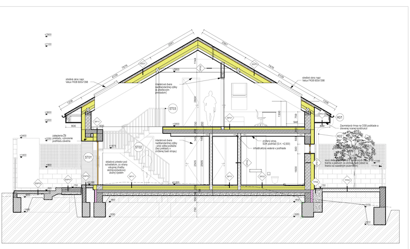

Another project and same situations or even worse. After hitting update button HLSV is taking ages to finish. Memory demand go up to 166GB!!!
File migrated from vw2019 into 2020 (file size 450MB) ... Mentioned viewport in attachment.
I will greatly appreciate any help or explanations what might cause this issue and how to deal with it.
