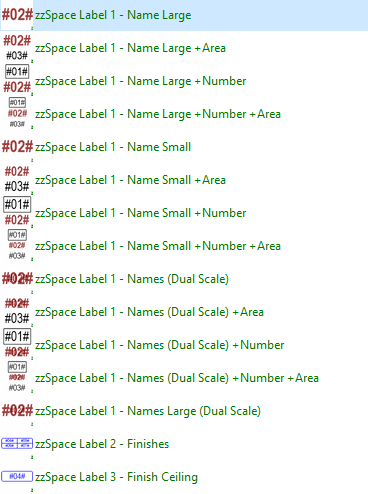

I am having a good experience at the moment using space objects and I am just on 2019. The project I am on atm has only about 20 space objects in it and it is just used for room names, areas and finishes which is generally all we need space objects for.
Others may have more complicated setups but here is what we do:
We have some custom space styles with custom tags. My biggest advice would be to get your first space style set up correctly. And by that I mean go through every setting to how you want it. You can then happily go and duplicate/edit this space style to create new ones and they will retain the basic set up.
We have set up everything by class with all nested space objects using "by-class" settings where possible. These are the classes we have set up:
These are some of the styles and tags we have set up:
image.thumb.png.5876ca51dee5eee86da86ecabedfd7eb.pngimage.thumb.png.920eddba654b058a8ffe2e9582dde868.png
