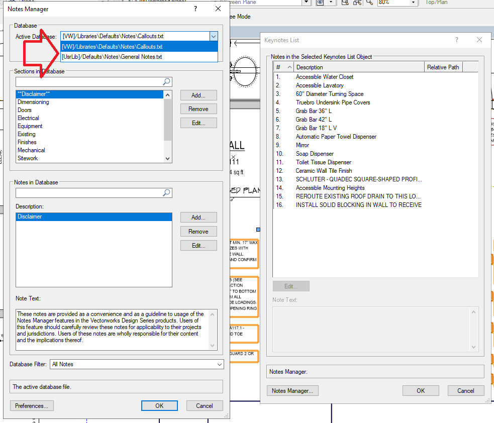

I'm sorry for so many questions. Let's start with the second question, please. See the photo.
1. Are these two separate files (or databases)? See the photo below.
2. If so, why? Can I merge them easily? Is seems to default to the [VW]/Libraries\Defaults\Notes\General Notes.txt - I've been saving to the [UsrLib]...database.
3. When I go to this user folder, which one is there? [C:Users>Lee Calisti>AppData>Roaming>Nemetschek>Vectorworks>2020>Libraries>Defaults>Notes
Yes. These are two separate files.
Vectorworks ships with two notes database files; one for Callouts "callout.txt" and another one for General Notes "general notes.txt"
These are just sample databases provided as convenience and as a guideline. Most users will create their own databases.
These default databases will be found in the default library application folder. You can identify them in the Notes Manager with the prefix [VW].
They are Read-Only files. If you use them and make changes, you own copy will be saved in your User Folder. You can identify them with the prefix [UsrLib].
Why separate databases for Callouts and General Notes?
It is just a preference. They don't have to be separate. But having a separate database for general notes allows us to provide a good default database tuned for the General Notes tool.
Yes, they can be merged. They are text files. If you open them in a text editor, you'll find that the structure of the database is pretty simple. You should be able to copy the data from one database to another.
If the question was why are there separate notes with the [VW] and [UsrLib] prefixes, see answer to question 1 above.
When you go to this user folder,  see your own custom database. The one with the [UsrLib] prefix.
