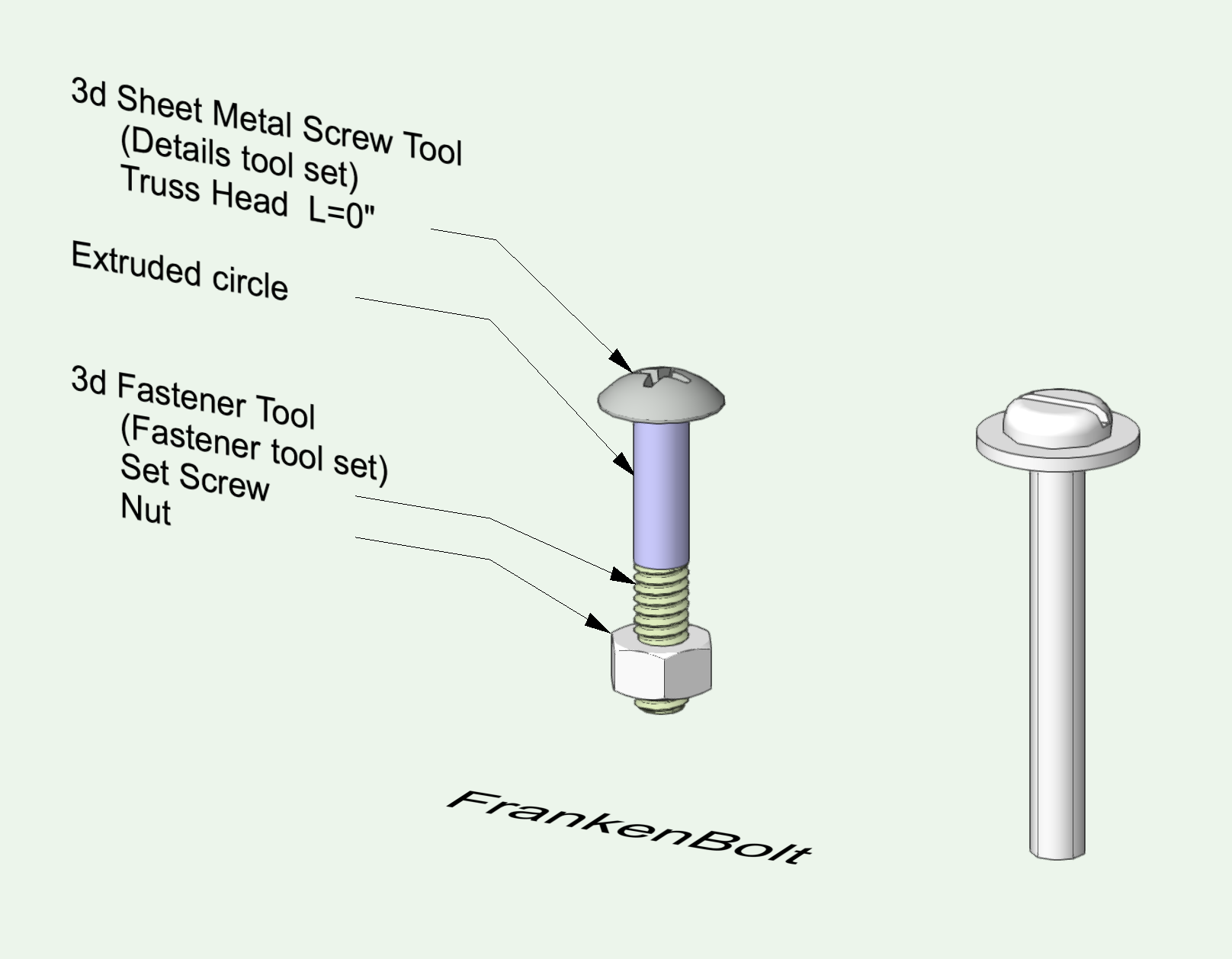

Phillips Head Fasteners ?
Fastener Tool and other options in the Fasteners tool set seem to avoid the phillips head or cross slot options.
I've often wondered about this and think it's an oversight - overlooked for many versions.
Should be corrected! Let's make a wish!
The Detail tool set includes "cross slot" 3d Wood Screws and 3d Sheet Metal Screws.
Also, why are these fasteners in the Details rather than the Fasteners tool set?  Seems legacy rather than logical
They can be moved/added to the Fastener Tool Set via the workspace editor - if it's worth it.
One could make a Symbol combining a screw head and a set screw and some washers (not shown).
@cberg Messed a bit with your file. Sorry 'bout that.
