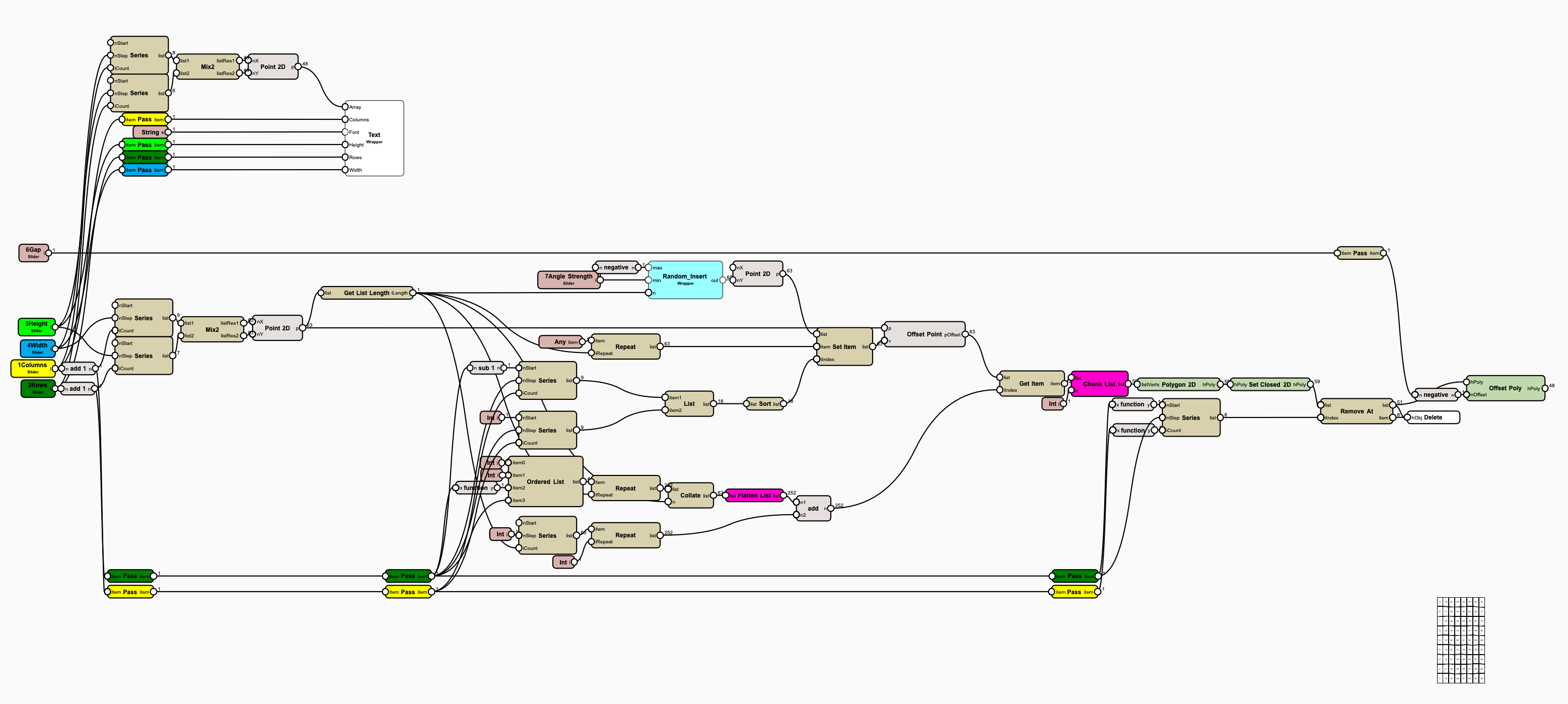

I've actually done it. It doesn't convert to an object node. The "Set 2D Vertex" node fails inside the object node. @Marissa Farrell can you confirm?
@mickcullinan you need to pick the offset values out of a list of random values and apply those offsets to the vertices in each poly. Looks a bit messy because I was not able to enter more than one value for the "Set 2D Vertex" node. I think that is actually supposed to work. I suppose you want the top and bottom rows to remain flat on the outside. The "Remove At" node is good for picking every nth value. Careful if you have more offset values than polygons because the last poly will receive the last value in the list. Better to strip the excess ones using "Split List" (although that's kinda hacky).
This can probably be done more elegantly but it works.

Added some numbering and introduced a second random parameter. Now, each of the four vertices is randomly moved in y direction. It's actually something I needed as well so you're in luck 🙂. I have filed a bug about the object node not playing nice with the "Set 2D Vertex" node so once that's fixed this will be quite a fun object to play with.

After some major refactoring (actually, a rewrite), the network has become more elegant and much smaller. Modifying the points before they are fed into the polygon proves much faster and more manageable. Now, it's also easier to add more options (movement of vertices along the x axis?). And since the "Set 2D vertex" node is now redundant, the whole Marionette works as an object.
