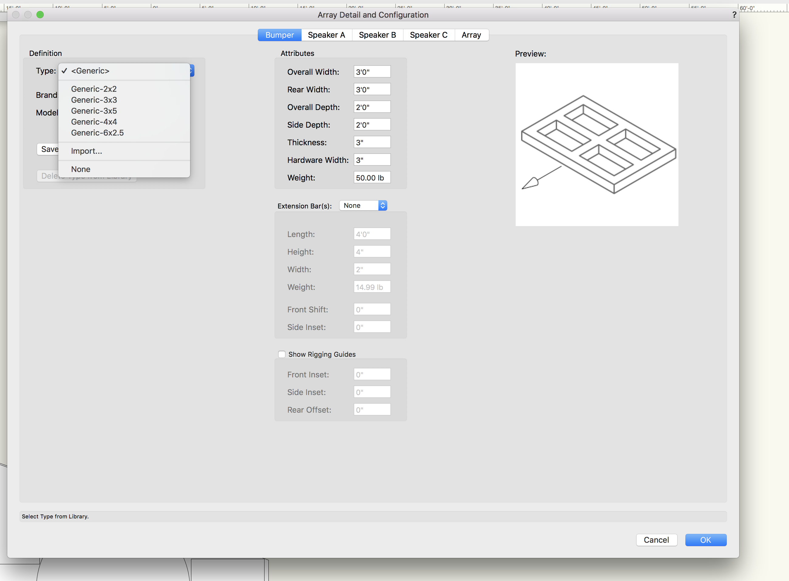

Hi all,
My Speaker Array tool Speaker setting has the import option to use non-generic symbols from the spotlight library
My speakerArray tool Bumper setting is lacking the import option.
I have already dropped the speaker bumper in the default folder and i just need to get that import button
Is there any particular steps/setting for it to appear?

  • 0
Thanks for the reply, ASagatoVW
I am indeed modifying an existing array. Screen shot below attached.
I also followed along the VWX videos about arrays and how to import them. Worked great for speakers, not so much for bumpers.
Share this post
Link to post

  • 0
@Chris_W Hm... I don't think I've ever seen the specific results you are seeing. You are not only missing import, but you are not seeing the default library either.
Inside of your Applications > Vectorworks 2019 ( or Program Files > Vectorworks 2019 on Windows ), do you see a file in this path?
My guess on this would be either the library file is missing or you do not have proper read/write permissions to it.
Since I haven't seen this before, it might be best to reach out to technical support and have them dig into it directly on your machine.
