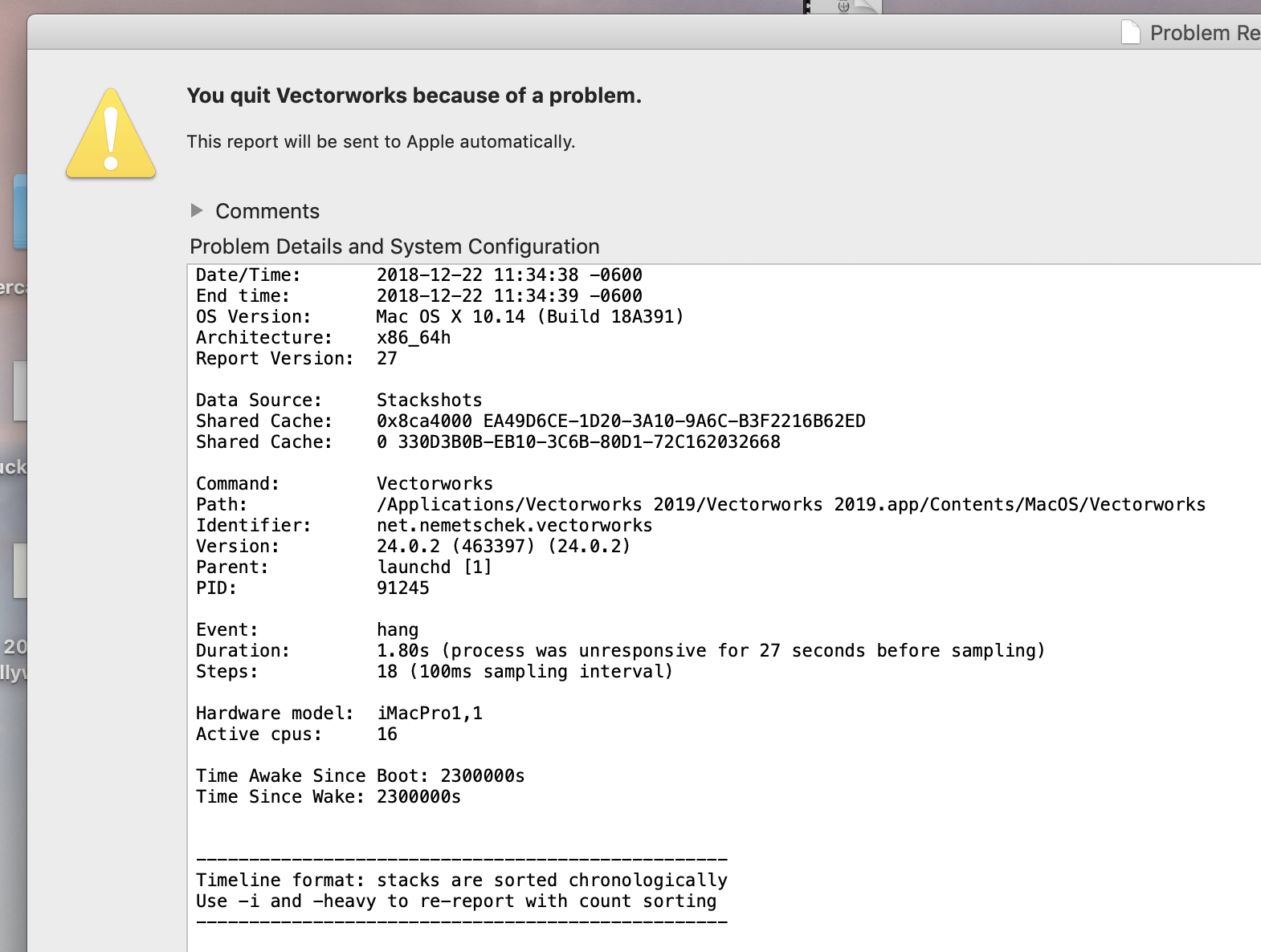

0 The Cantor 0 Posted December 22, 2018 VW hung even on a new/clean empty Spotlight file. Restarted VW 2019 opened new Spotlight template created a rectangle created second rectangle, to use to create viewport on new sheet layer double-clicked on the auto-created annotation showing the scale of the viewport spinning hanging ball appears. Screenshot of top of the report sent to Apple is attached. HELP... Quote Share this post Link to post
