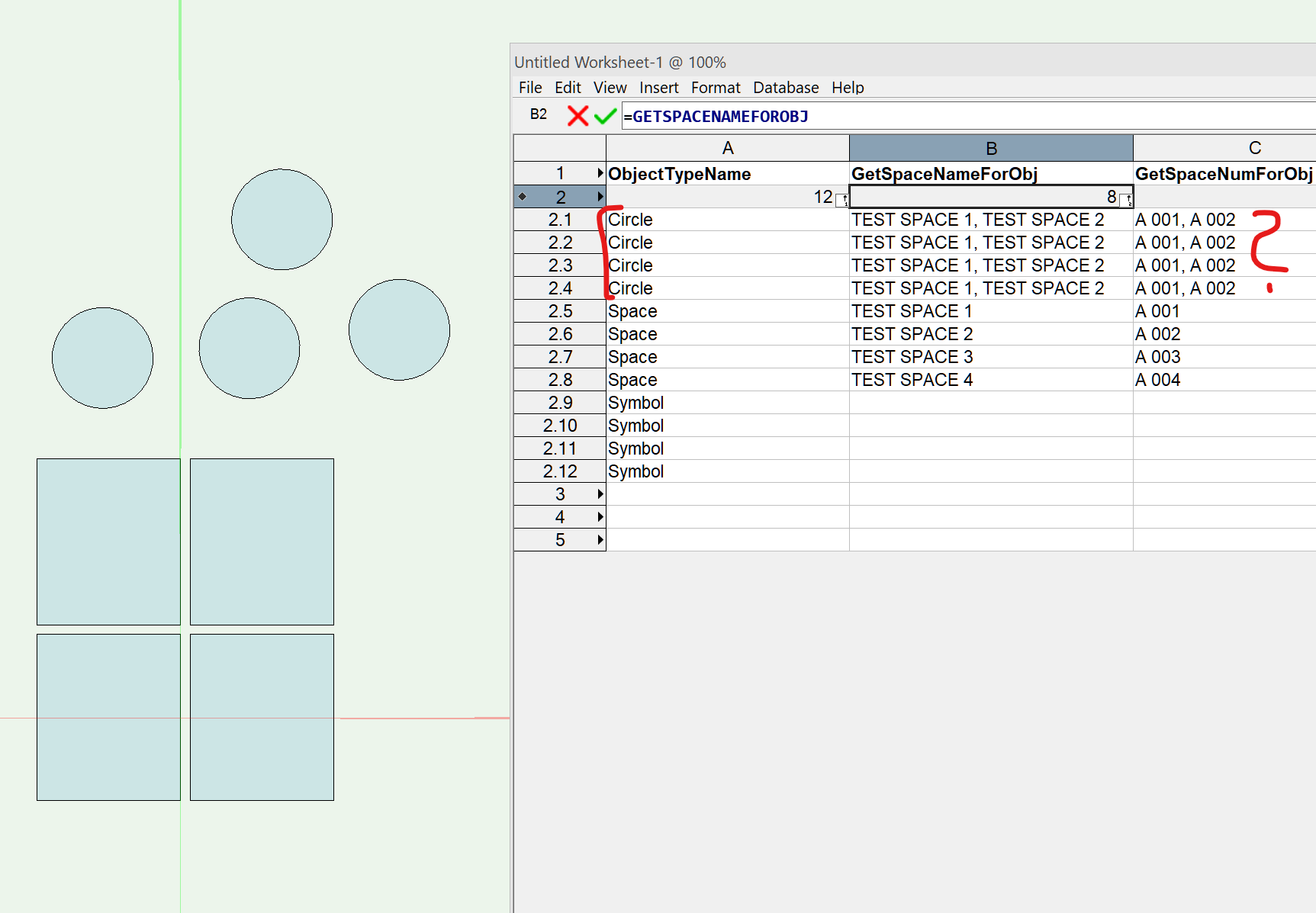

For context, my use case is as follows:
I am setting up a template for housing scheme layouts, using Spaces as 'plots' and symbols (with attached records) for house types.
I want to be able to schedule the houses to include the number of the plot (space) which they overlap with.
Using "GetSpaceNameForObj" I am able to achieve this with simple polygons, but not with symbols (as illustrated in attached).
Hoping there is a workaround, or an alternative method to achieve this?
Thanks.
(Using VW Design Suite 2025)

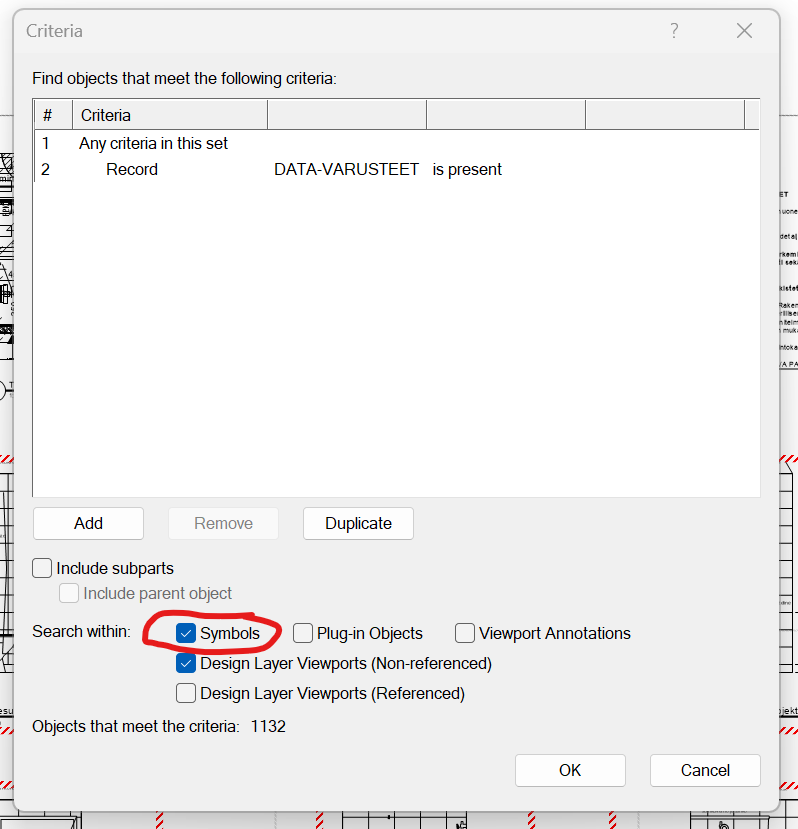

Hi,
The function does work, check that you have this ticked in the worksheet criteria:
Also, the elevation of the object must be exactly at the same elevation as the space object: if your space object Z is 3500, then the symbol has to be at that height as well.
If I remember correctly, the function is also aware of the 3D dimensions of the space object (if you have it set), sometimes one can get double spaces and in that case they usually are overlapping in 3D. Or, you might have two flat space objects at the same elevation.
Hope this helps.

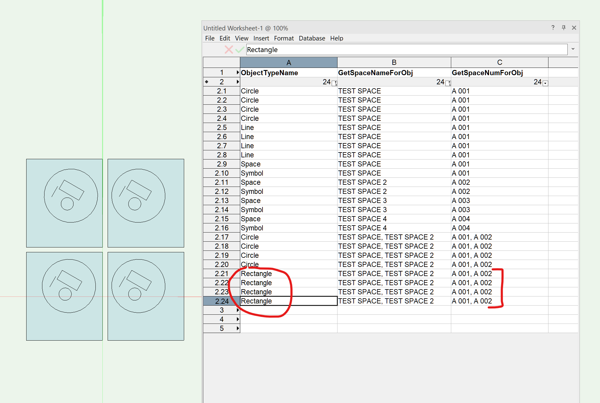

3 hours ago, JMR said:
Here you go, it's a VW 2023 file.
image.thumb.png.6371bd1a6a06a802808eebd04bd83406.pngE
Thank you for the file @JMR. On first glance it all looks like it works correctly but when I mess around with it - add/remove objects, move things around - I start getting strange results. For me it is the same as @Martin905:
  • GetSpaceNameForObj + GetSpaceNameForObj does not see objects inside of symbols. Convert the symbol into a Group + then the nested objects are seen.
  • A symbol won't be seen unless it includes geometry in the Top component.
This is in VW2025: perhaps it's different in VW2023...

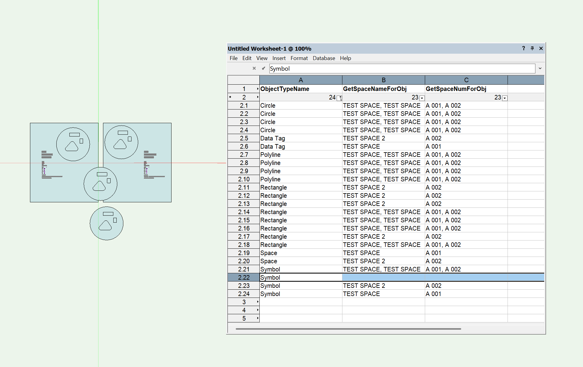

  • 0
Bummer....I can replicate the above both in 2023 and 2025 Design Suite: It appears that the first time the symbol and the symbol within symbol are created and placed, the Space is detected correctly, but if one moves things around, the worksheet will get stuck in the first calculation...very strange.
Trying for a 2nd time...now I get SOME of the objects to the worksheet, but not all:
moving symbols makes the worksheet to lose track of the objects:
