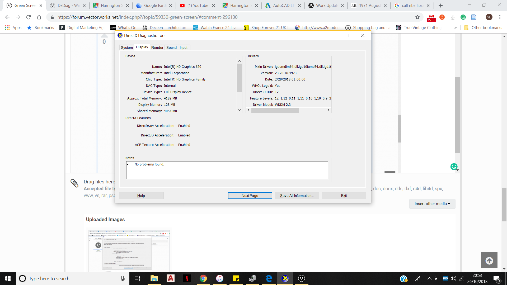

0 Sade Posted October 26, 2018 Author Share Posted October 26, 2018 5 hours ago, Jim Wilson said: One or both of these are the cause for sure. Reply back with the following @Sade and I can take a look: I tried both of these and nothing worked. photos attached. Quote Link to comment
0 BSeigel Posted October 26, 2018 Share Posted October 26, 2018 Do you currently have a graphics card installed? According to the diag you are using the Intel HD 620 integrated graphics from your processor which aren't recommended for our entry-level system requirements. (Although, it can work for some files) https://www.vectorworks.net/sysreq Quote Link to comment

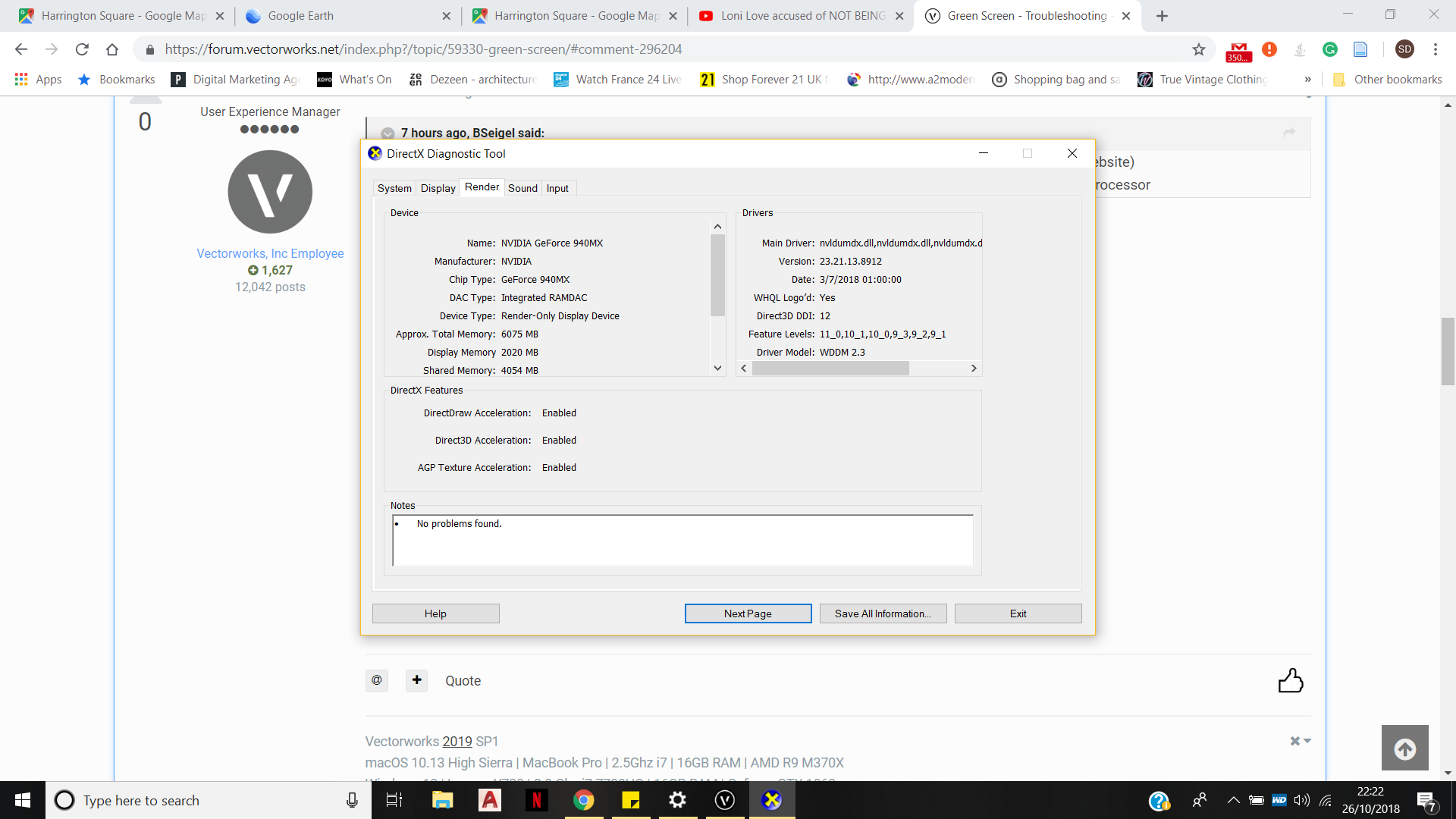

0 BSeigel Posted October 26, 2018 Share Posted October 26, 2018 Can you please send another dxdiag to verify that you are using the Nvidia card? Quote Link to comment
0 BSeigel Posted October 26, 2018 Share Posted October 26, 2018 Cool, the card is definitely enabled. Now you just need to change the graphics settings to use the card for Vectorworks. Ive linked an article for doing just that. 1 Quote Link to comment
0 Sade Posted October 27, 2018 Author Share Posted October 27, 2018 @BSeigel Yes this worked, thanks! I had a few issues with updating my graphics card but when I finally did it worked and I've had no problems so far. Quote Link to comment
